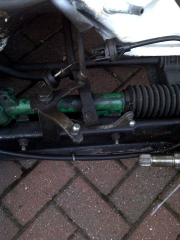

Gearbox... the car is early 89 so I'm thinking it must have came with a later BE3 type box even though it has a BE1 type gear knob,
are the linkages different in length to account for the reverse gear, the box going in will be 1990 BE3, can anyone identify from the
photo which linkages these are or are they all the same? The 205 is still fairly new to me so apologies in advance for what must seem like easy questions to most of you.

reverse opposite 5th is BE3, reverse opposite 1st is BE1, BE1 has a lift up for reverse knob and a cable that goes through the bulkhead to the gearbox. The release bearing and operating arm, linkages and clutch petal / cable are different as well. (conventional clevis pin BE1, Plastic hook and loop affair - BE3). Your photo looks like BE3 release cable but BE1 boxes can be converted to BE3 release arm and cable so be careful.
Have a search on here - loads of info.
Gear linkages are the same between be1 & 3.

Thanks for the info, the head is good, built by this man http://www.mikestewartperformanceengineering.20m.com/index_1.html many years ago and gave our 1.9 8v a 15 second quarter mile, it's been stored ever since, so we will replace the valve stem oil seals and go from there. Thanks also for the details regarding the box types, I think we will just need to see how it goes together for ourselves and amend/change anything that is needed when the engine/gearbox is fitted. The car is 1989 but has the early type gearshift (lift up for reverse over first) - Tom is saying the linkages are the same, so we will figure it out no doubt if needed to.
