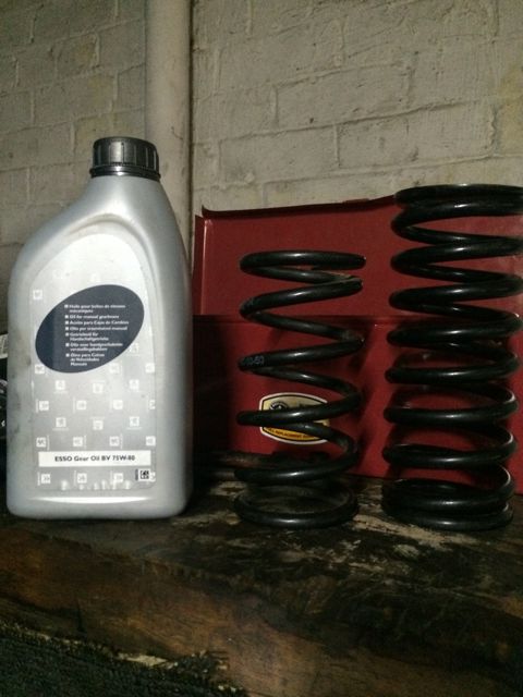

Not sure if this will help but photo shows Bilstein with 10" free length gravel/forest spring & insert
the bare spring is 10" tarmac spring. Learning curve for me right now too concerning coilovers,
but I know as much as yours should not be bottoming out unless springs are too soft or ride
height settings are wrong?

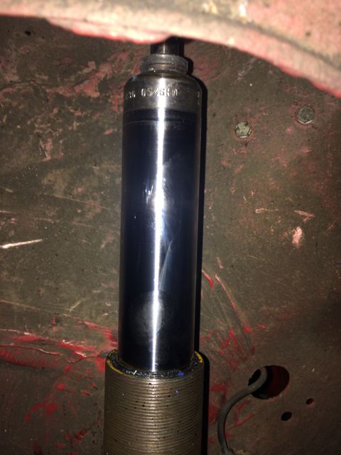

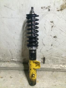

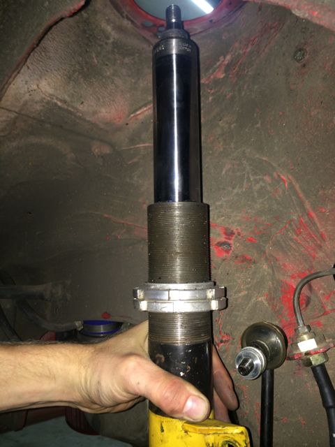

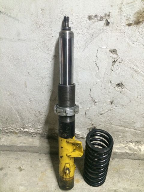

camgti
Here are some photos of what I have at the moment.
I ve also got some 6in springs that were actually better but were 285lb and too stiff
Cam
camgti
Compared to the photo from MacCrash . My springs have the same amount of coils, yet are 1in shorter. Will this be adding to my problem?
Even if I wind the spring pans up the height of the car does not raise, the springs just compress further...
Does this mean the inserts are short?
Or the springs are usless..

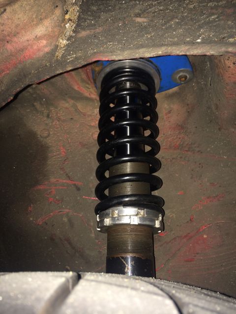

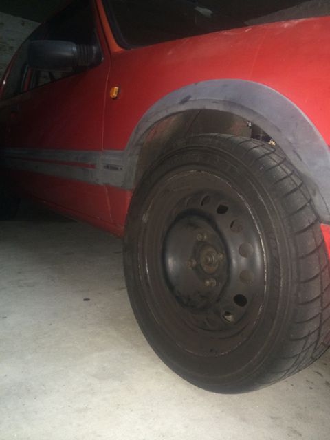

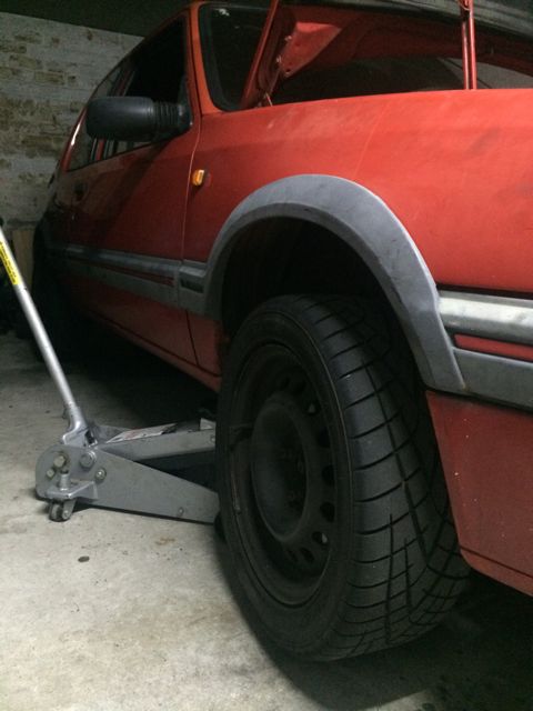

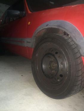

Heres a pic of the height of the car. Its low but not that low.

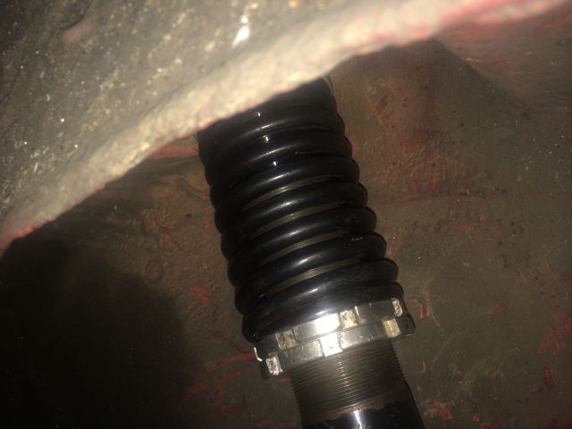

Hers a pic of the spring at the hight on the ground. Not the best as its with the phone up under the guard but you get the idea. Definitely looks like springs are binding. Really pissing me off.
Do springs 'settle' so to speak? And if so, whats a normal amount? Im starting to see the age old saying ( and I should know better ) "you get what you pay for". I actually ordered these springs to test the rates and how they felt and then order something fancy. Rates seem balanced with the rear rates.
