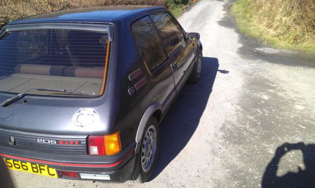

New to me and it's a non sunroof phase 1 and wasn't a lot of Money either,obviously needs work, but engine runs fine and pretty original

It was sitting in a wood yard since 2005 and was dry stored,so things are gonna be seized,
Engine a bit hesitant when revving and ticks over at 1400rpm
So will go through it slowly and see what needs attention
Bodywork ok, minimal rust

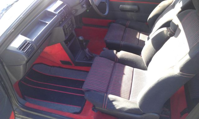

it has the clocks that are not standard,not sure why this is?will put some pics up now, maybe someone can answer that one lol

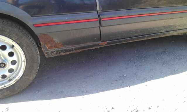

i did look in the boot and inner wings and all rust free so i'm lucky in that respect
AFAIK those clocks are correct for the very early Phase 1's.

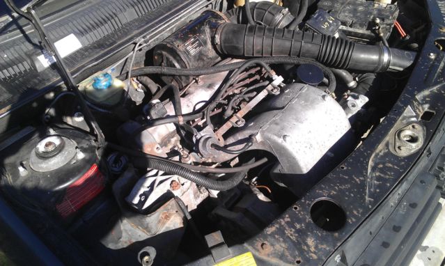

That should be the early 105hp 1.6 engine too at that age, which must be getting pretty scarce now! The lack of breather pipe on the cam cover looks to confirm that too.
Indeed, at a glance it all looks quite original :)
Miles
Yes the clocks are original and even the seats which are the first things to go

By the interior I would say that this has to be late 85 or early 86 model. The dash is late ph1 (early ph1s hat that textyle look), new style gear knob, non-leather steering wheel, but old style stalks and old style instrument cluster support that and look original.
jackherer
The B registration means it was registered between Aug '84 and July '85.

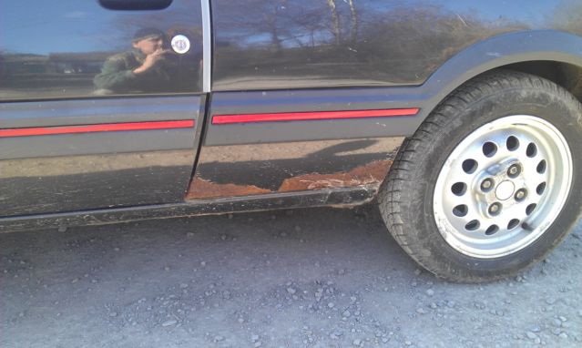

The rust put me off a bit, how bad are the rear panels?
erbs
Nice little find, I had my eye on this as it's only up the road from me in Carmarthen, didn't notice it was such an early model!
had a poke with a screwdriver,seems solid, surface mainly

went to the pug today to sort out the hesitant running, so i went and bought new leads,dizzy,rotor and plugs,replaced them and fired it up and now runs sweet
revs through the range fine and no more hesitant lumpy running
noticed the radiator is goosed so that will need replacing,left it running to see if the fan kicks in at temperature and it worked perfectly
will also change cam belt and tensioner and water pump for good measure
still ticks over very high,now it ticks over near 2000rpm, any ideas?

My guess would be it needs a very good clean out and check for air leaks as a place to start mate. Some of that rubber is bound to have perished over the years.
There is a lot of useful info on idle problems on here that helped me a lot.
forbeslongden
I had an absolute nightmare with my 1.9 where it was not only sitting at 2000 at idle, it would also cut out for a good twenty minutes of a journey. I think the general consensus was that there was an air mixture problem, one thing I did know for sure was how much petrol it would get through!
