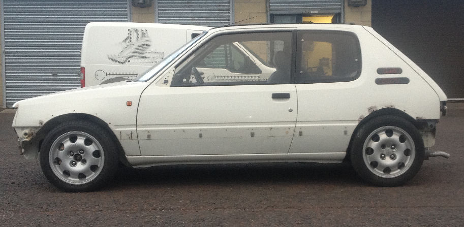

Any pics from the side? and do you know the shock bolt centre to centre your's is at?

312mm between shock centres AFAIK. Crap pic below, will get a side one done shortly :)

Yep, had the figure from Anthony and asked R Mountjoy/SSP Engineering to set the beam at that, and with my Eibach 7001's on the front, it looks about right I reckon.

Thanks ATK..... yeah looks the business....... could do with a wash though!

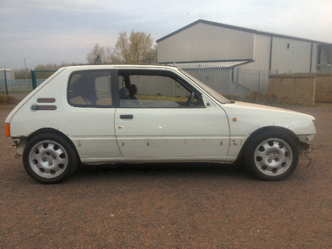

This is how it sat a few months ago with an aged OE front, and the beam/lowering done.
Does it look too low?
Also, the 300mm is what i measured with the back of car on ramps and front on axel stands slightly lower, so probably slightly different from what it will sit at when its on all fours.

on all fours with the new front shocks/springs on..... (still to fit new rear shocks)
Anthony
It's quite low - hard to say exactly how low without the arches but guessing 40-50mm - but does look like it's sat broadly level
The extra weight of a GTi-6 engine does noticeably lower the front I found. My Eibach's whilst perfect with the alloy 8v engine were too low for my tastes after I put the boat anchor GTi-6 in the front, probably dropping it another 10-15mm.

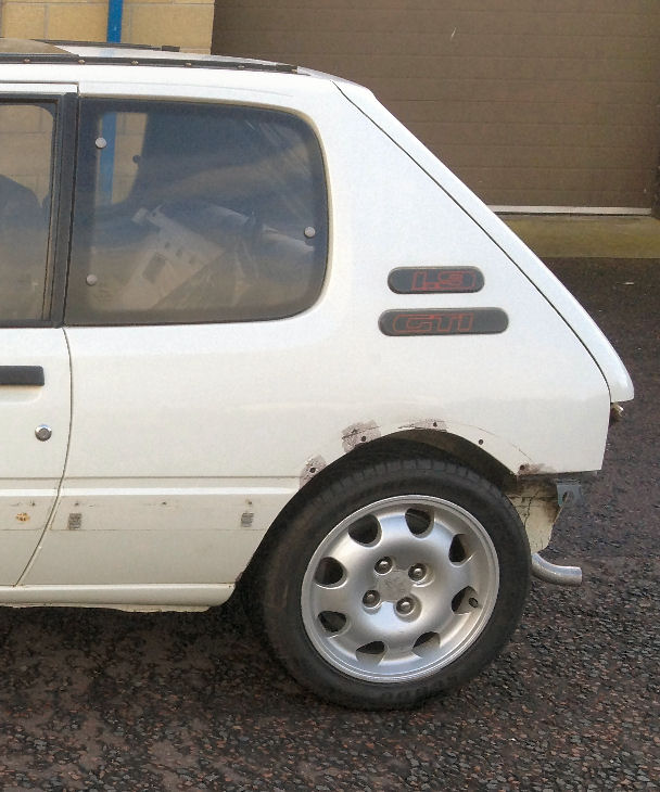

Thanks Anthony, i have a spare bodykit so i might try hold it on and take another pic. (If anything i think its sitting lower at the back.)
That was me just reversed it out the garage with new springs/shocks on front, so maybe it will drop a little at front after a few miles?
ATK, could you take a measurement for me please? (from the road to the horizontal part of the back wing just above the bumper?)
