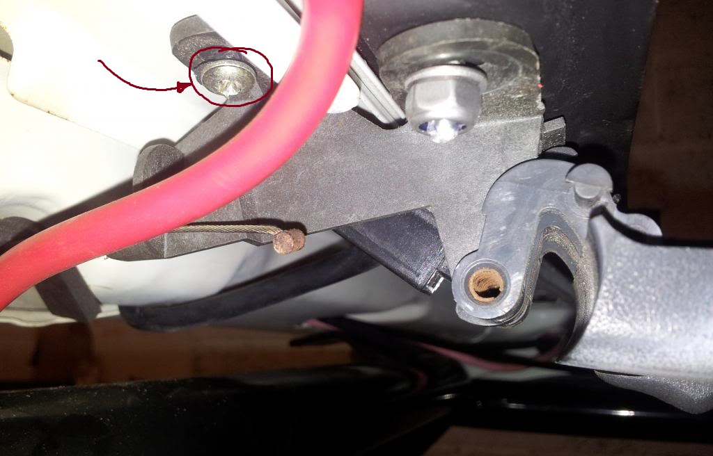

Paul, I didn't get around to taking a photo of the screws I am having trouble with, but found a great shot on the forum that someone else had already taken.
I've circled the screws that won't come out.... they just keep turning and I didn't want to have to remove the headlining or damage anything. It's all in good nick up around there on mine and don't want to do any damage - especially to the headlining!

Clarky3rdNut
Recently had this apart myself.
The self tappers hold the front section of the external sunroof trim in place.
They should be screwed into these captive clips. I only have a photo of my destroyed trim but you get the idea.
If the screws are just turning then I'd imagine the clips have come loose or it's been botched in the past. Apparently a lot of people don't realise the screws are there when they remove the trim and after a good tug, the clips break off.
