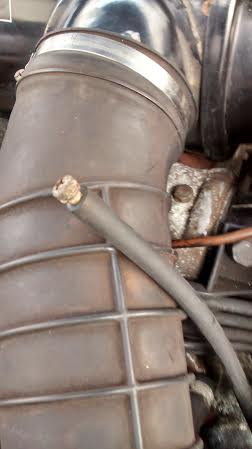

Hi,
Just trying to sort out the emissions on my car. Connected to the vacuum device tucked under the dizzy is a hose....is this meant to connect to anything else? I cant spot anywhere on the inlet manifold whee it can go!

Goes to the throttle body underneath if I remember right?
farmer
That's right Slo, quite hard to see but put your hand under there should feel something.
Worth checking that the vacuum advance unit isn't broken while you're there, as most seem to be these days and it has a noticeable effect on fuel economy and responsiveness on part throttle.
Easiest way is to try sucking and blowing through the pipe - if you can't then it should work (suck hard enough and you'll hear the plate move inside the dizzy) whereas if you can suck/blow through with little resistance then it's knackered.
As has been said it connects to the underside of the throttle body.

Aha, now located - someone has blocked it!

Blocked at the vac advance end!
Almost certainly done as the vacuum advance has failed I'd say, as it results in a small airleak in effect.
However, a failed vacuum advance won't be the cause of any MOT emissions related woes.
Typically, high CO is rich running (eg AFM, ECU temp sensor) and high HC is poor combustion (eg ignition, cam timing, low compression, incorrect fuelling)
