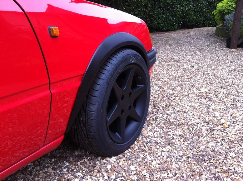

Really wanted to keep this car looking more like an XS than a GTI body wise and wanted to try and minimise the amount of flared arch I could. I bought some fibreglass arches which looked a little over the top so next tried the GTI plastics, this in turn looked too much along the sideds. I had a think and decided to modify the GTI arches and remove the side plastic sections and convert them into more of just an arch and keep the sides of the car more looking more stock. I think I have achieved this and and very happy with the look :) any views??

Looks pretty good but need to see some profile pics.
Talk us through the mod. Looks like you've joined part of another arch to the bottom, cut and blended it in and then (presumably) its been painted over with some textured paint. How's it been joined? Plastic welded or just fiberglass filler?

Hi, used original arches which although in plastic are not ideal when using fibreglass. I cut off the side sections from the arch and used an angle grinder to remove moulding shape and to key the arch. I then drilled many holes and grooves in the arch so that when glassing/forming it flows through and creates a strong join from both sides like a sandwich. I placed plastic tape similar to insulation tape (but wider) on the body and fitted the cut arch in place. I used fibreglass matt against the plastic tape to form the inner shape and then when that had gone off used fibreglass P40 to create the shape. Once this had hardened off I removed and fillered to form the perfect shape. It is pretty strong and can twist quite a bit and did not show any signs of cracking. I primed/painted the arch and then used the bumper/trim die to match the bumpers. I thought I would need a textured paint but in reality if hardly shows that there is a very slightly different texture. I have to be disciplined with this car and not be too anal as it is actually a road/track car and as such does not need to be perfect bodily/cosmetically and I have to try and keep that mindset.. :) saying that I want it to look good ;)

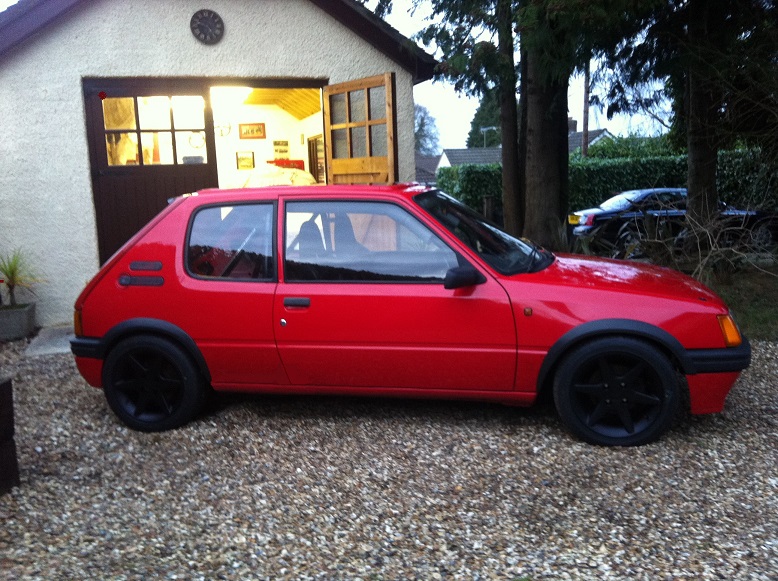

Only side profile I've got at mo....

I really like that. I've never been a fan of the wide arches with the odd (squarish) shape and the rivets etc. What you've works a whole lot better IMO.

Cheers, thanks... I'm trying to keep the car as minimal as I can but rims dictate a certain amount of arch...

That looks brilliant, very purposful :)
calvinhorse
It's a yes from me :)
Andy_C
That looks really good. Subtle too. Clever modification!
Tom_Gallington06
I'm loving the look mate and the build. :-)
