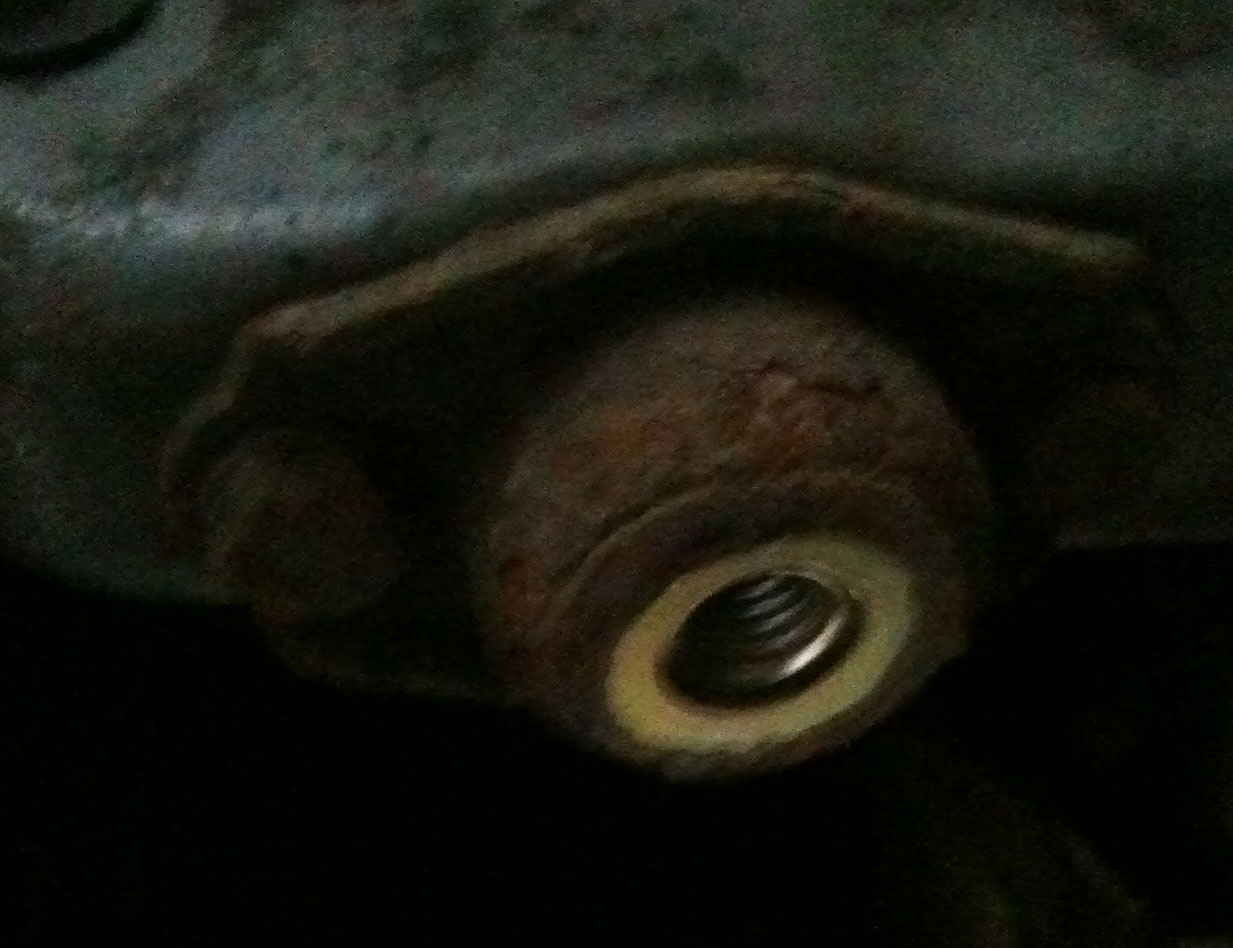

Pardon my ignorance, but what am i missing between these 2. I assume its a mount of some sort?
And
What size bolts do i need for the rear part where it bolts to the chassis?

there's a mounting on the base model between those two, M8 bolts into the captive nuts in the chassis leg and it has a stud poking down which is M10.
its a base model subframe, track control arms, not wishbones.

If you can find some subframe mounts off a 309 gti as they're solid metal with no rubber in between.

nope, that's a gearbox mounting.
