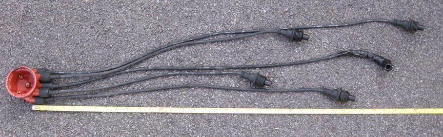

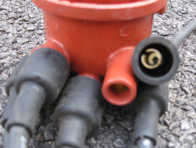

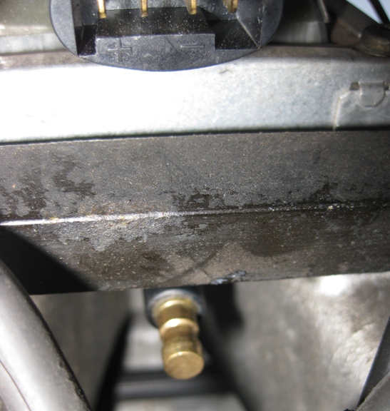

Hi, my 1.9CTI isn't running very well and I'm moderately confidant it's the HT leads. I've been to the local motor factors (APD) and they've looked it up and can't find the right ones in their book, despite getting the right distributor cap!

The distributor cap has socket (for want of the proper name) type connections:
and the coil has pin type connection and is mounted on the inlet manifold:

If anyone has any good idea what the right leads are or where to get them I'd be grateful?

looks like a 1.6 gti cap, so a 1.6 gti lead set would work.
1.9 has male ends on the dizzy cap.
Most lead sets come with both types of coil lead due to the change over, If not just get one by itself

I've a late 1.6 and it has the male ended cap too. I think this is correct for the late 1.6's.
I got a set of leads off Ebay ok, just going by the diagram showing the end types (i.e male or female) for each of the leads. I was looking for the 'all male ended' set but there were difinately a few different sets available.
try GMF or Gloucester Motaquip

If you look at the first picture I posted you see the order of the HT leads in the cap, assuming yours is the same that's one thing you can rule out.
