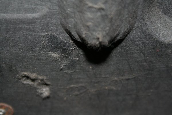

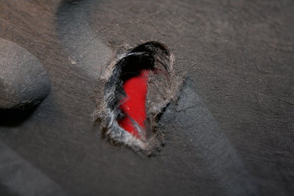

Crap ! haven't seen this before , so the bonnet lining can be asbestos material ?
http://www.miamistu.co.uk/pug/GB/205F/7/79A10A.HTM
.. doesn't say actually anything ?!
Mine started disintegrating in few areas , and i'm actually living/sleeping in the garage next door .. guess it's best to take it off then ?
