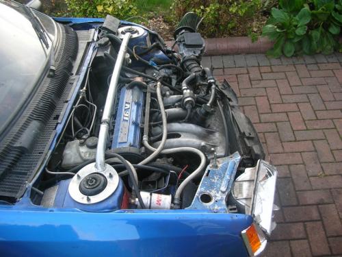

Matt Holley
Not sure what you mean by firewall? If you mean inside, my way doesn't put fuel lines or pumps inside the cabin.
This is a pic of mine fitted.

I had a Facet red top competition fuel pump on mine when running carbs like what Mat says you will need to fit a hose that goes to the tank.I fitted my fuel pump exactly where Mat did and never encountered any issue.If you do go for a Facet fuel pump be aware it makes a constant ticking sound.

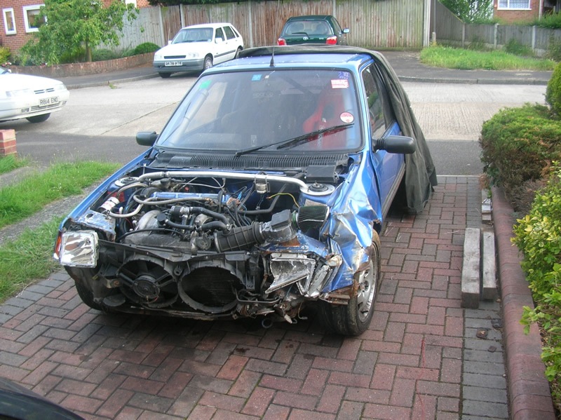

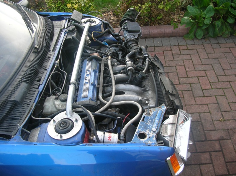

I'm never comfortable seeing fuel filters or pumps in that position. After my friend crashed his 205 into a tyre wall at Brands everything forward of the strut was quite neatly moulded around the wheel/tyre, luckily he hit the passenger side so his fuel system was intact but if it had been the other side it would have been a bit of a mess.

Matt that's great thanks, I had thought about fitting it there but as it is a track car I would be worried about the position as that is exactly where it would take an impact as per the car in the pics, imagine if that had been the other wing, fuel lines, hot engine etc.
