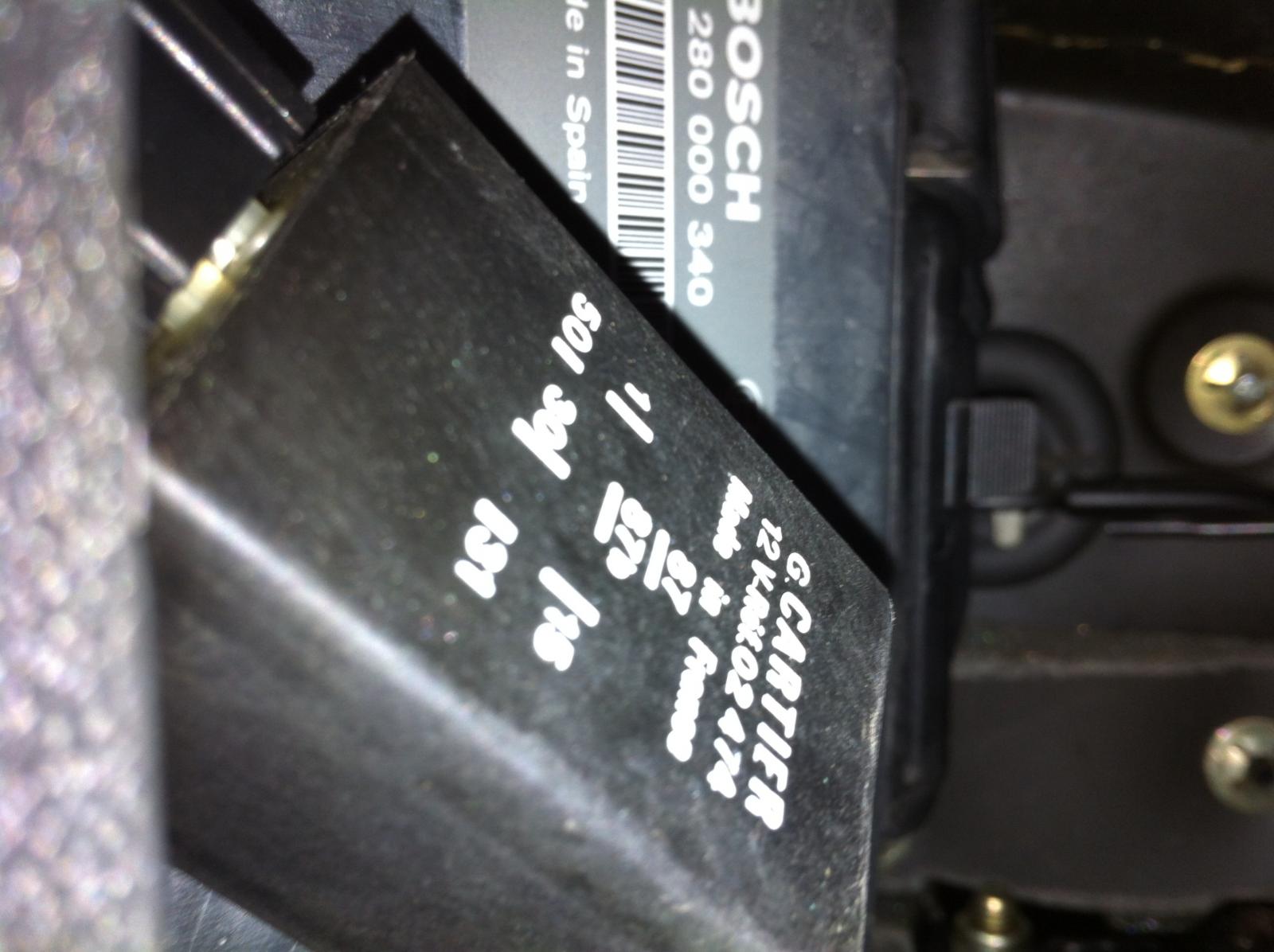

Is that the one to the right of steering rack? I take it this rules out the pump?
farmer
Yeah should be around that area. It's a 7 pin relay.
willis

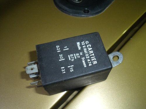

Looks like this?
Edited by willis
farmer
Should look like that with 7 pins.
Edited by farmer
willis
Yes, that's the kiddie. Thanks guys.

Often the solder joints In the relay fail, You may be able to repair.
£120??? Sold my last one for £5!
farmer
0000145205 RELAIS 99.17 GBP 99.17 GBP 119.00 GBP 119.00 GBP 119.00 GBP 119.00 GBP
