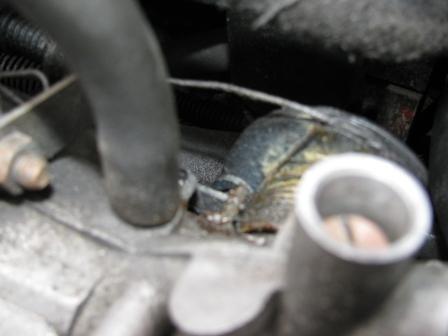

Just had a look at the throttle cable - is it supposed to be like this or much tighter? it does seem a little slack to me but i think its always looked like this!
stick a brick on the pedal and check if there's any more movement.

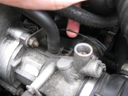

With regards the throttle cable, as above, get a willing helper (or a brick) to fully depress the accelerator and make sure that the throttle is fully open (ie it won't move any more by hand). It doesn't look excessively slack in the photo though, but it's not really easy to tell.
with the pedal fully depressed its no exactly tight- i can still move it fairly easily with my finger
ok sorry i get it now, so with 4 bricks on the pedal there is absolutely no more movement in the throttle switch
