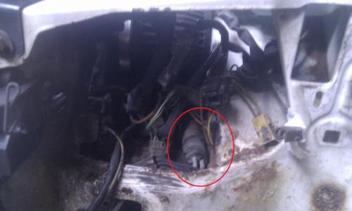

Anyone know what this is? its behind the headlamp underneath the k&n filter.
ORB
Fan Speed or Dim Dip resistor, I forget what one is on what side though
aronw2004
ok cool. it look'd like it was loose there, so i wasent sure if it had moved from some were. there is another one on top of the rad also
it should be in a metal clip under the headlamp not sitting on the inner wing, needs sorting as it gets quite warm so not ideal having it sitting on wiring.
