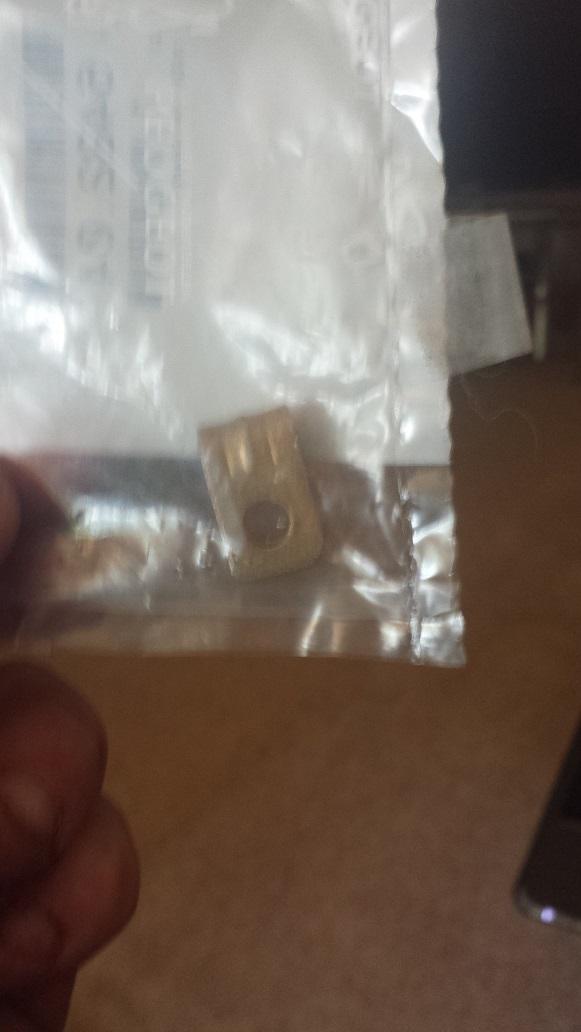

chipstick 382 1 Cars Posted June 23, 2013 Now have my valance off and the holes cut. All I need to do now is secure the vents in. I could drill some pilot holes and use self tappers, but would rather use the correct sort of retaining clips. What would such a clip be called where would it likely to be found? It appears to be similar to the style used to hold the rear fog/reverse lights but able to grip material twice as thick. I tried expanding one to no avail. Share this post Link to post Share on other sites

welshpug 1,622 Posted June 26, 2013 could just buy the clips Share this post Link to post Share on other sites
chipstick 382 1 Cars Posted June 26, 2013 (edited) I looked on servicebox and couldn't see any on the exploded diagram of the rallye bumper. Had another look and only thing it could be is 6992JO but that just looks to be a large version of the clips used in dashes where a screw goes through it. If that is the case I can use those and drill through also. Edited June 26, 2013 by chipstick Share this post Link to post Share on other sites
welshpug 1,622 Posted June 26, 2013 I believe it would be 6992J0, agreed it looks rather vague looks to be used on the 306 and partner left and front wheelarch/bumper liner under the alarm siren, a 4x4 ax rear mudflap and front arch liner, and a berlingo roof console panel clip Share this post Link to post Share on other sites
farmer 327 1 Cars Posted June 26, 2013 (edited) I had a rummage about my parts and found the wee clip that holds the bonnet release cable to the front panel may be usefull to hold this in place. Granted it has a hole through it but folds over on its self and would slide over the valance i would think. Edited June 26, 2013 by farmer Share this post Link to post Share on other sites
chipstick 382 1 Cars Posted July 3, 2013 Do you have a pic of that Farmer? I've some of the 6992J0 on back order (no idea how long that takes - dealer reckoned a few days) I rummaged through my clip jars and found something ideal but only had the one Must have come from a 306 interior somewhere Share this post Link to post Share on other sites
farmer 327 1 Cars Posted July 3, 2013 Can get one. Slo needs a photo of that part to. Share this post Link to post Share on other sites
