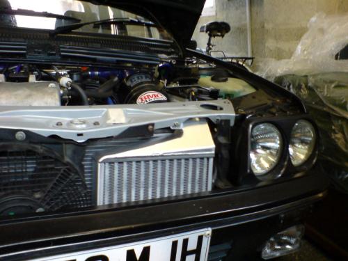

stef205
this is mine.
i don't have many mid build pictures of the mounting but this should give you a idea.

Paul_13
This is fully hidden behind the front bumper when fitted

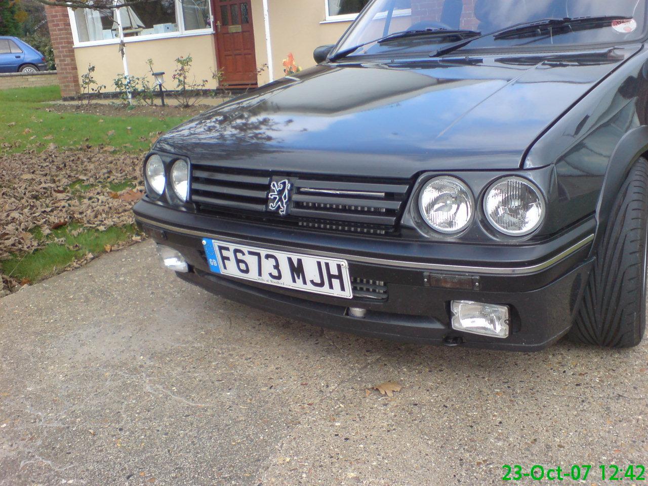

Mine lives behind the black grille in the bumper.

No you won't if you fit a (slightly adjusted) Cosworth i.c., like i did. With an original frontvalance it ain't a pretty sight, imho. But i used a 309 frontvalance.

of course you could, all you need to do is drop the rad on a few brackets, or buy one of tom's brackets, fix off the shelf aftermarket fan to radiator or a fabricated bracket.
a. you will need bonnet pins or a strengthened slam panel.
b, that's just from poor workmanship/choice of parts.
c, as above.
I would not go under due to ground clearance and adding to boost pipe length.
As above, I made a stiffener strut to go from the slam panel down to the lower x-member. This is essential as otherwise the slam panel is too flexible and you can't latch the bonnet shut. With this strut it is solid.
