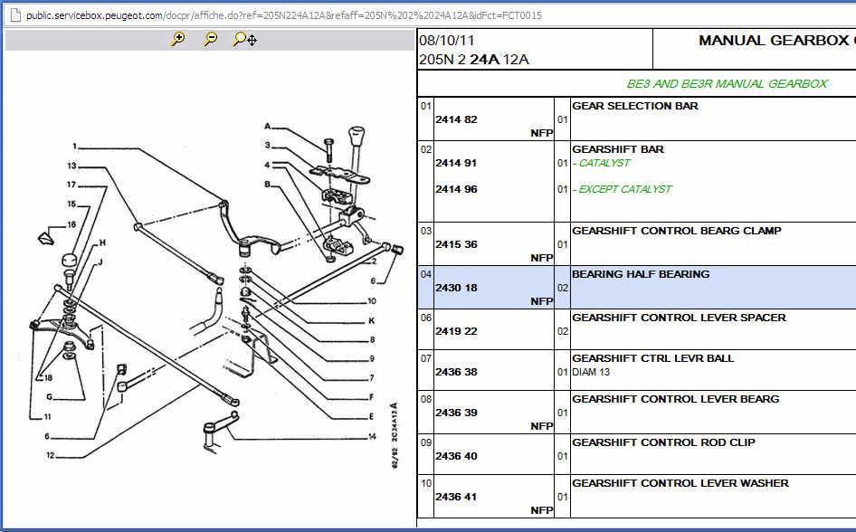

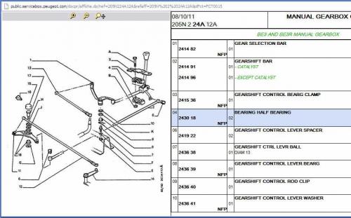

Which part of the gear selection has popped off?
Also, the part which can be 10mm or 13mm won't need replacing imo, it just bolts through the subframe & the lock nut works loose so two minutes with a socket set & open ended spanner will see it tightened again.
Item #7 (+F & E) in the pic above.
Personally I've only seen them in 13mm & a quick look on service box (peugeot parts portal) I can only find a 13mm one listed.
If its one of the other gear rods that keep popping off, a set of uprated gear rods which are held in place by a clip are a good investment & cheaper than new standard rods from Peugeot.
