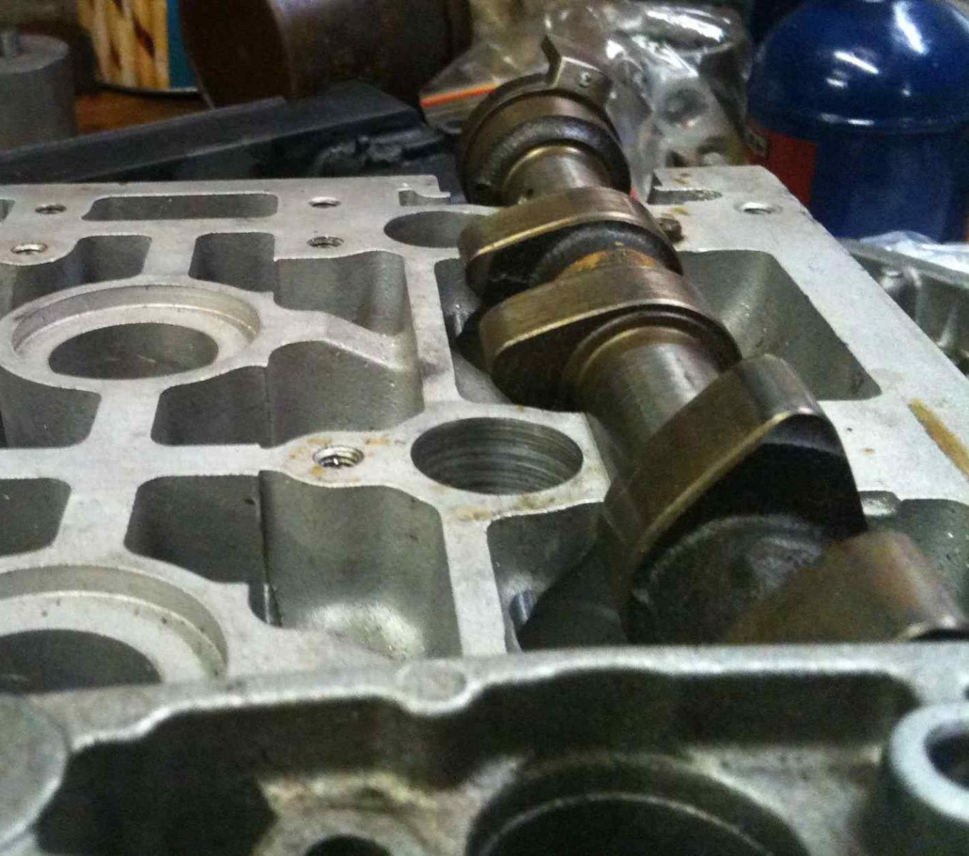

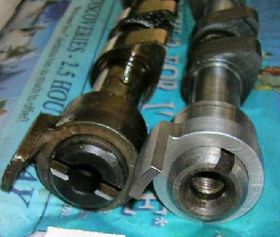

Geoff Clements (jorg) is offering a Stage one PeterT inlet cam for a S16 engine... But it's missing the injection timing tab... Since i have a 205 running a standard citroen ZX 16V engine (similar to the 306/405 ones) i would like to upgrade it to take this cam (should be a straight fit)
Can the tab be exchanged between cams?
How to set the 'timing' / 'position' to the tab?
Can this be done by someone with some experience of rebuilding engines?
(I've done a rebuild of a S16 head and a complete TU5J2 engine)

Mark its position relating to the lobe next to it, then press it off :)
Might need top heat it as well, but I;ve not tried to remove one, PeterT would be best to ask.
Willem_Jacobs
Seems to be in the exact position of the number 3 cylinder lobes (counting distr > flywheel) i'm just wondering if it can be done, using just simple tools...
Depends what you call simple tools...
Willem_Jacobs
got pretty much all the tools for a engine rebuild available, it's just the bearing regrind stuff i don't have the tools for. I managed to install the piston pen on a TU5 engine for example... (needs to be heated / cooled to remove / install)
It's a heavy press fit. I have got them off in situ with a modified 3 leg puller, but ideally you'll need a 10T press. The exact position isn't critical.

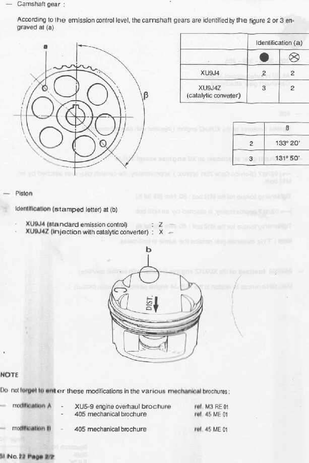

So it's the 148 bhp rated engine that should have #3 ones fitted???
I assumed it was later 160 bhp ones that had #3 ones and the 148 bhp rated that had the #4 inlet....
I'm confused now....

damn, i really should sleep some more.... i somehow misread the table on your site... :unsure:
Peter; Do you happen to have a pic of a #3 pulley (marks stamped in it) around on the web... i want to source one as fast as possible and since my parts are nowhere near where i am right now it's difficult for me to explain where the marks should be on the pulley....
Edited by Willem_Jacobs
Best I could do at short notice.
