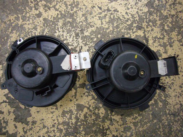

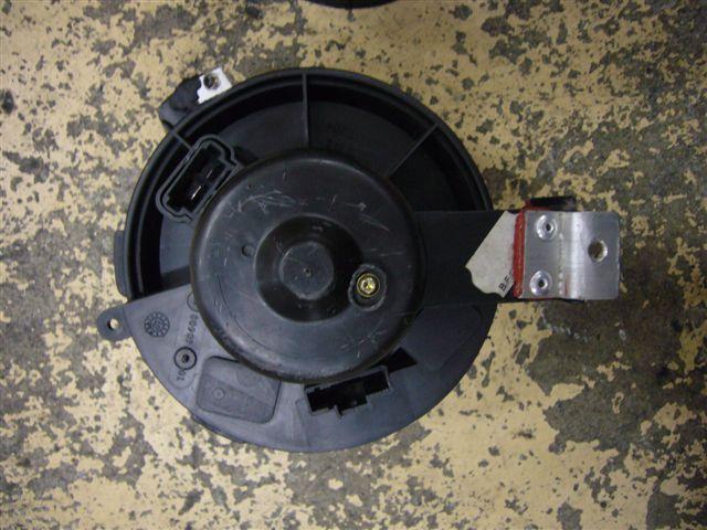

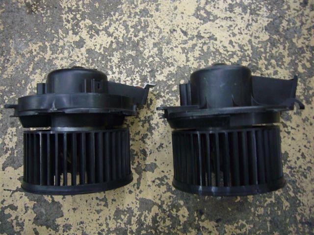

I somehow got myself a 206 fan blower motor from scrapy and my friend modified it for me. Now it blows much stronger than the last time I have a new 205 blower motor.

they look the same :lol: I'd swap the plastic casing over if they are that close.
did thought about it but found out swopping the casing is harder than doing such simple mod.

Also, in the pics, one is the modified 206 motor, is the other a standard 206 one for comparison? Because neither looks like the 205 one i know - yes i am probably being stupid here but i had to ask since i thought maybe yours was an air con car (being HK spec) and had a different heater box/motor setup.

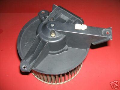

Sam you are right, I only have 206 motors in the picture. Since number of 205 in Hong Kong is "easy countable" so finding one for comparison seems very difficult. I have one picture from ebay for your reference.
iirc the fan blower motor is the same for both a/c and non-a/c spec (correct me if i am wrong)
afaik you have to modify the socket as well.
