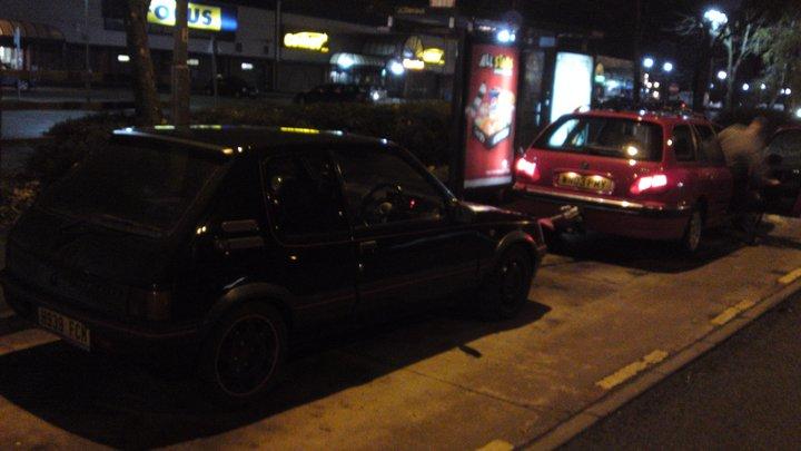

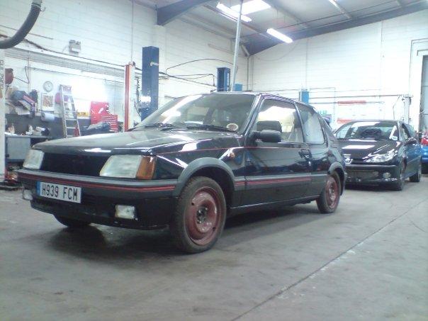

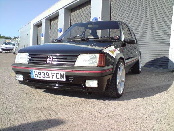

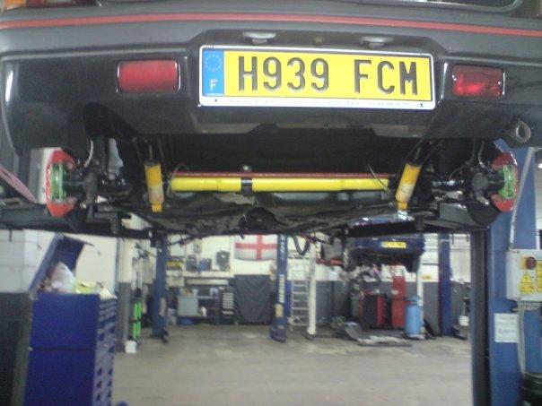

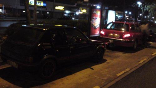

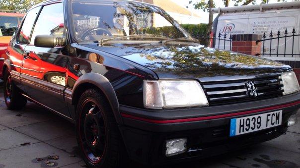

meak89 1 1 Cars Posted January 14, 2013 Hi all im a new member to the forum but have been looking through it for about 5 years,i will run you through a breif history of my 205 before i get to my spec and questions when first brought after a couple of months after fittng two engines and fitting my 3rd thought i would give it a mechanicl restoration and this is what it looks like now and this is where it spends most of its time Right the start of my project was to buy a 2.0 8v turbo (for bottom end and turbo feeds etc) so luckily one came up on ebay local to me so off i went and got it brought the engine is now out and the block will be going to the enginers soon but i wasnt going to go to this length but i figured if im going do it im going do it once because im feed up of removing-instailing engines in my 205, block; 86.5mm forged pistons have the block skimmed polished or reground crank depending on condtion balanced rods lightend flywhhel (dependant on how heavy a gti-6 one is when i get to weigh it uprated oil pump head: gti-6 head balance the head skimmed and tested valve steam oil seals vernier pullys 270 inlet cam (unless anyone can suggest anyting else) manifolds; standard inlet manifold custom exhaust manifold (i think i read that wracing made some manifolds and would consider one of those) turbo; gt28 (unless the are any other recommendations) fuel; 330cc injectors would the standard fuel pump power enough for 250-270bhp? managment; i was hopeing to run std managment and have it set up on a base map for start up the have a proper rr map when engine was run in, so what i have belive in 'peter's budget 2.0 16v turbo topic is that he is running the gti-6 wiring loom with the 2.0 8v turbo ecu and then beem mapping it him self, if this is correct then that is great if im wrong i would appreciate any help when it comes to this bit intercooler; i was going to use the 2wd cossie interccoler and liked the layout of the SOS 205 where the boost pipe goes under the inlet but then i saw a post on here where someone was using an intercooler with inlet-outlet at the same end like on a 1.6 hdi (but cant find it again because ive read so many topics my head is ready to explode) but then i thought it could be a bit busy in that area with both boost pies and coolant pipes extras (questions); ive seen people running metal thermostate housings is this just because of heat of do have to fit a custom one to get it all fit? do people run two slim fans or one? would it be best to run lamba sensor or not? there is probably some bits and questions ive missed but im sure i will get there in the end, my aim is not to have a massive bhp car i want something that is quick and reliable which is why im only looking for around 250-270 mark plus i will only be running std box until i can save up for that part after the engine is running sweat any help would be good on the manifold and managment please, would rather use std managment if i can help it Thanks Adam Share this post Link to post Share on other sites
