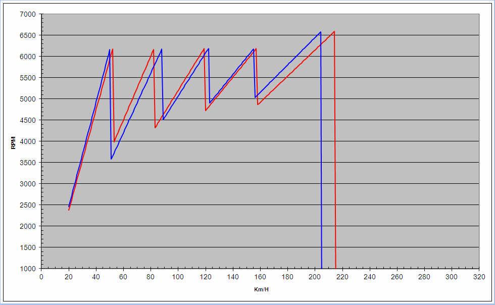

pug_ham 240 3 Cars Posted January 7, 2013 I have an early 405 Mi box on one of my 1.6's & I like it for road use, short 1st-3rd with a longer 4th & 5th but still shorter than the 1.9 box so a happy medium imo. The graphic below is a comparison of the 1.6 box (blue) & VTS / Mi16 box (red). g 1 Share this post Link to post Share on other sites
p1234 22 2 Cars Posted January 7, 2013 Ah, if only more in life could be explained by graphs, it would make things so much easier, thanks for that Graham, exactly what I was looking for. Share this post Link to post Share on other sites
