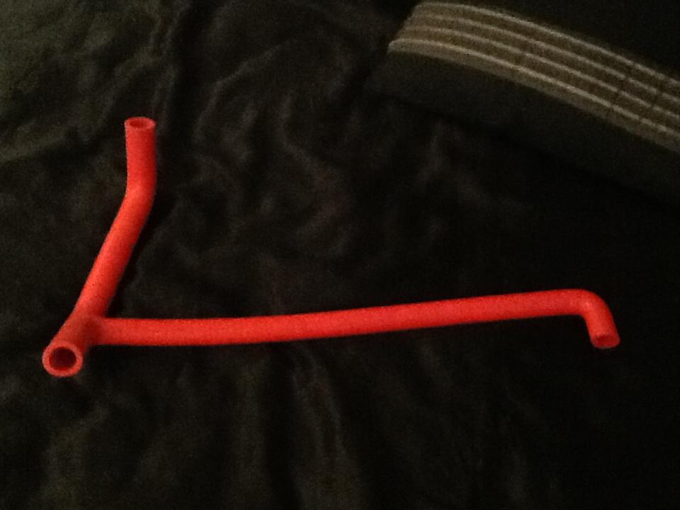

Hi just a quick one, I've stock piled all the parts I need for my conversion now and it's going in next weekend.
Just want to know where this pipes goes, does it replace the standard metal one that runs along the back on the engine ?

It goes between the thermostat housing, the expansion tank, and one of the heater matrix pipes.
The other heater matrix hose goes to the other point on the thermostat housing (the supplied hose needs to be cut to suit as it's actually an Mi16 / Ph2 8v hose)
The metal pipe across the back of the engine block remains in place.

That's Ideal mate thanks alot !
