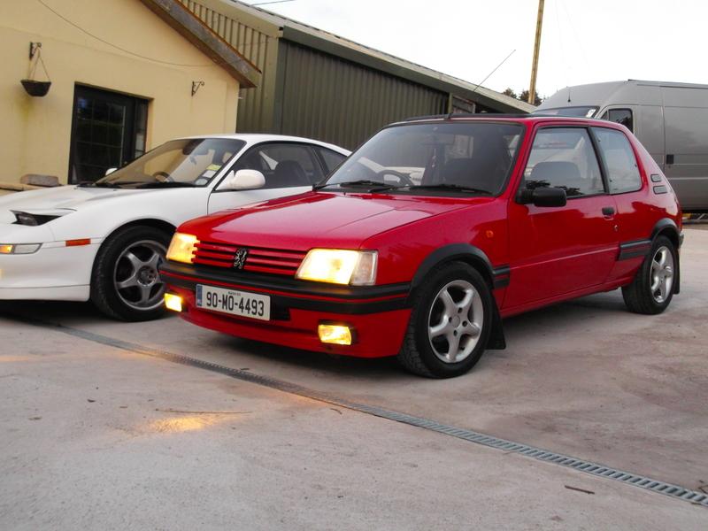

Ian205 3 1 Cars Posted February 8, 2014 had a thread on here before , cant seem to find it anywhere , so here it goes, over a year ago i bought this 205 gti 1.6 8v ​ i knew it needed body work, and a little tlc..but nevcer knew how bad things where, since i have bought it here is the list of spec of what i have bought for it *fully reconditioned 1.9 disk axle with new disks *new bilstein b4 shocks all around *new droplinks, trackrod ends , new rear axle bushings and subframe bushings *new airflow meter, cone filter k&n filter re-locaton kit *replacd front wiper motor, rear wiper solonoid *new radiator *new coil pack , dizzy cap , leads *reconditioned my 1.9 speedlines *4 branch s/s manifold into s/s exhaust system i think thats about all new parts i have for it, so then it came time for body work, now the car was resprayed before i bought it but they must have forgottem about under neath and up front. so i took out the engine and stripped down the front of the car ​ so as can be seen theres alot to to around the engine bay and front panel, while the engine was out i did abit of poking about i found these fitted to the engine ​ ​ piper cam and kent cam pulley so now its time to get down to the nitty gritty, i noticed oil seeping down from the top of the valves on 2 ports on the exhaust side, so now looks like i might need a head rebuild and while im at it may aswell do abit of bottom end work i am in the process of making a spit to mount the car up on so i can turn the car upside down to weld the sills where there are a few holes that need sorting. so when its up on the spit the rear axle, petrol and and front sumframe will be taken off the car to be cleaned seperatley and the underneath of the car and up front will be soda blasted primed, and scutched or stone-chipped, so thats it for now ..watch the space Share this post Link to post Share on other sites
sport1901966 8 Posted February 13, 2014 With that shopping list it sounds like mechanically it should be feeling pretty good now. Corrosionwise at the front end it doesn't look too bad... I've definitely seen a lot worse. Should be able to get away with cleaning up what's there with a couple of patches where required with any luck. Do you know what part number/spec the cam is? Share this post Link to post Share on other sites
johniban 59 1 Cars Posted February 13, 2014 Attack it with a knotted wire wheel. Looks in good nick compared to my Gti Share this post Link to post Share on other sites
Ian205 3 1 Cars Posted February 17, 2014 it is fairly solid, mostly lifted paint and surface rust, a few minor holes here and there mainly the 'skin' of the sills, and no sorry i dont know the model or spec of the cam, you cant find it out unless you remove the cam, which i havent taken out yet , i heard piper cams arent the best on the market for 205's? could someone clear this up? the shopping list is long, but far from finished! Share this post Link to post Share on other sites
