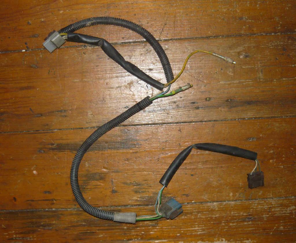

pug_ham 245 3 Cars Posted January 2, 2013 This a the fan loom that I'm currently repairing, its currently missing the shunt box connection (green wire) & earth terminal (yellow / green wire). Blue plug goes to the radiator switch, brown plug near it is the test plug, bridging centre pin to either side will run fan on low / high speed, grey plug is to the fan & there is the brown plug for the speed resistor behind it. g Share this post Link to post Share on other sites
