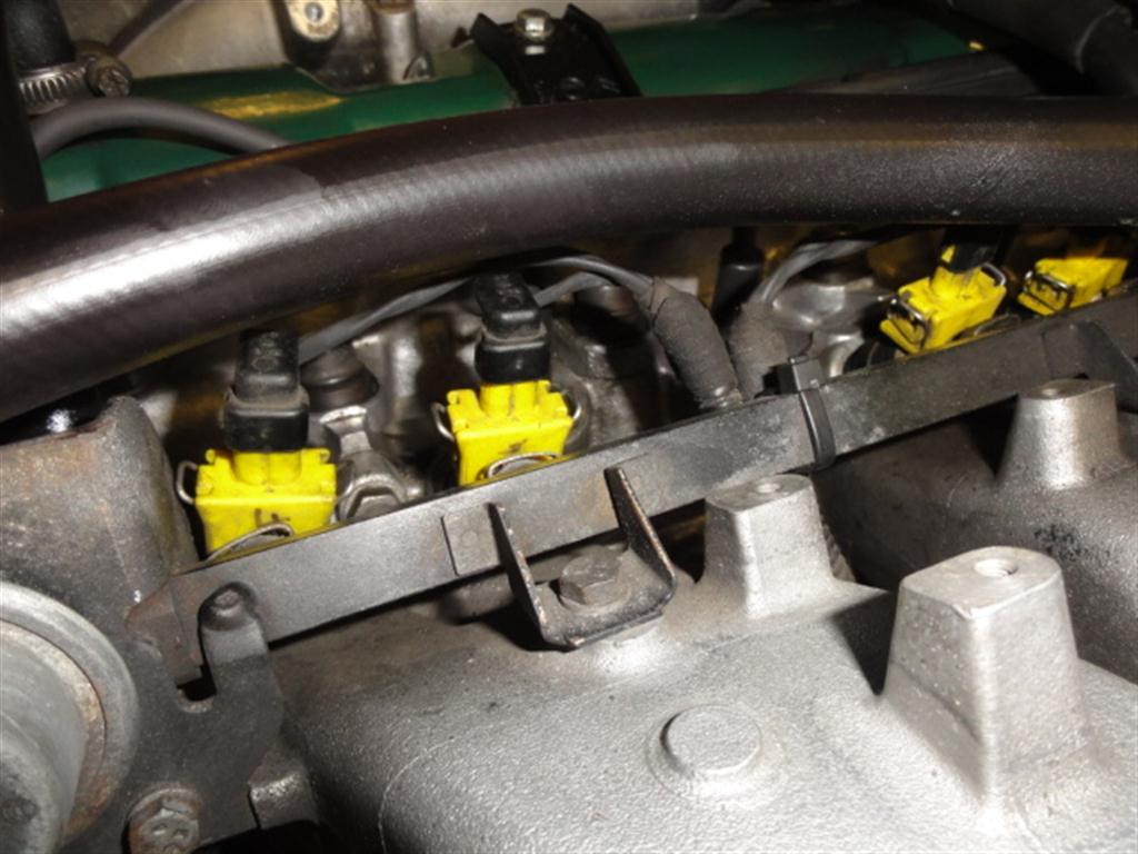

Hi friends
In the last touches of restoring my 1.9 , just in need for a tip , how to conceal the ugly wires of the injectors ? they're in a bad shape and i'd like to cover them with something , maybe some sleeve?
was thinking to make them on red. (just to match the spark plug leads)
what do you use ? recommend?

When mine was reloomed, Vauxhall injector connectors were used and they are a nicer fit than the originals! As you can see, they were heat shrunk and in pairs.
