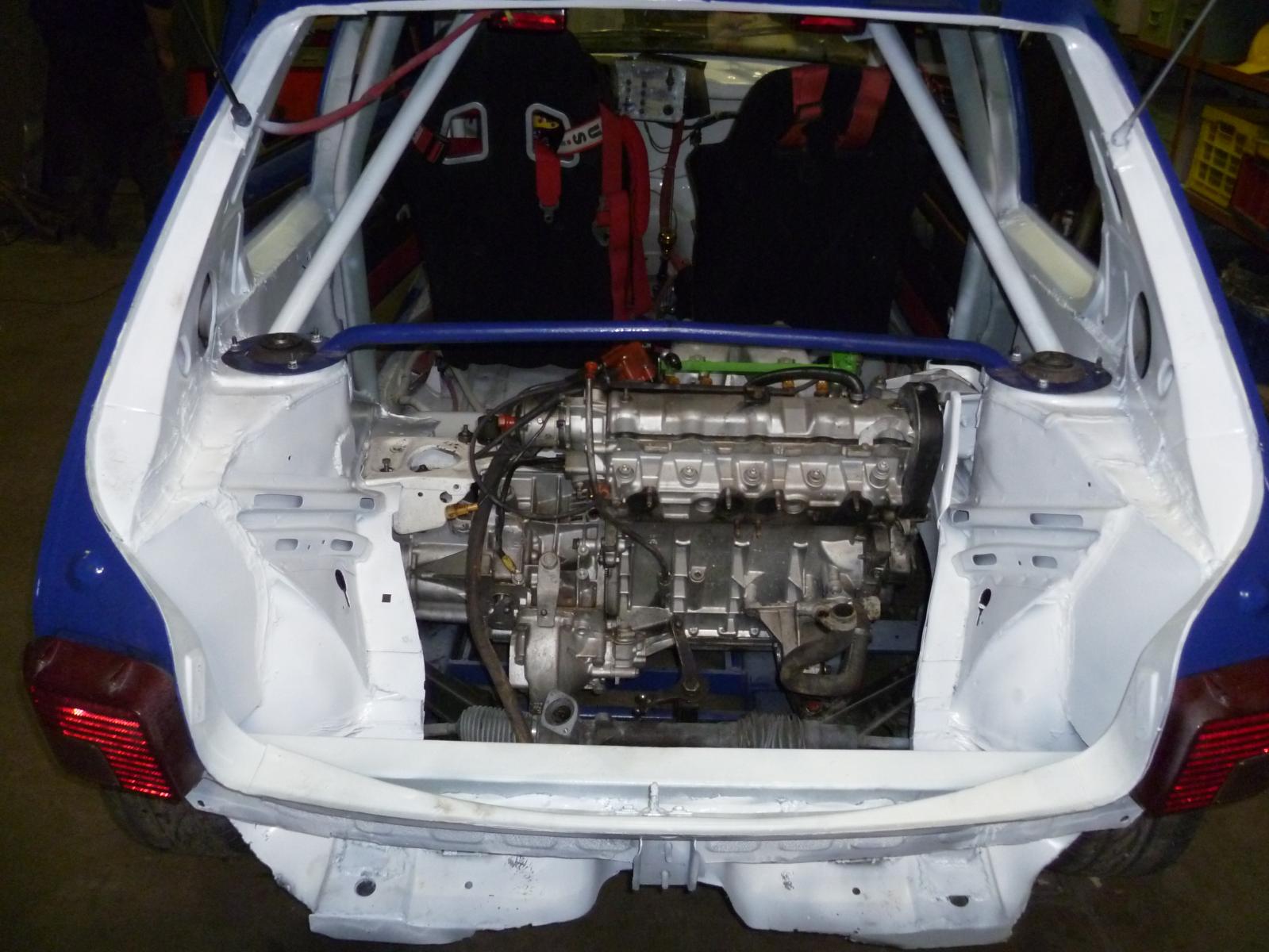

Hi guys i have a 205 1900GTI with the engine build in the rear of the car.
Now i want some extra power and i'm thinking about a turbo powered engine;
Has anyone some experience with this or isn't that possible with that engine

The engine is placed in the back of the car yes

Thanks cybernck for the link. The car on the picture is that yours?
I have read the story and seams to be verry easy to instal a turbo
You dont have to do something at the compressions or pistons.
But i don't know if 0,4 pressure is much for a turbo.

Where can i found some pictures of your car on this site
I have watched but i havent found something about your project.

You have build in 2 engines in the car, that was a lot of work i think.
I have just replace 1 engine and worked a lot of houres on that.
In the weekend i will place more photos, my car is almost ready just the clutch and vacuum for the brake servo
What are you doing with your car trackdays or something like that?

FONZIE
It's for rallycross the car so it's not for road use
Like i said i'm gonna test the compression in the weekend and then i'm sure wich engine it is.
