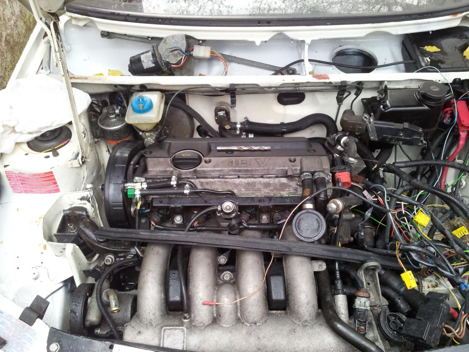

Brilliant, thanks guys i'll try putting it back into the 306 and let you know how I get on. Just incase though i have already ordered an unlocked ecu off fleebay. Im the mean time here is a quick pic of the project in its current state.
