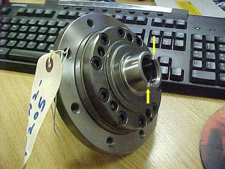

cybernck 400 1 Cars Posted November 5, 2012 Does the speedo drive have to be changed when the final drive is changed, to remain accurate? If it's driven by a driveshaft then I guess not, but it's been a while since I've had a working speedo . Share this post Link to post Share on other sites
pug_ham 240 3 Cars Posted November 12, 2012 Does the speedo drive have to be changed when the final drive is changed, to remain accurate? If it's driven by a driveshaft then I guess not, but it's been a while since I've had a working speedo . To get it as close to possible when swapping gearboxes between different models of car yes. The speedo drive is driven off the diff, the plastic cog which the driveshaft slides through has a notch which locates into the side of the diff as seen in the picture of a Quaife diff from the website article; Using the standard Xsara VTS speedo drives on a 205 will give an approx 3.36% so your speedo will over read slightly. g Share this post Link to post Share on other sites
