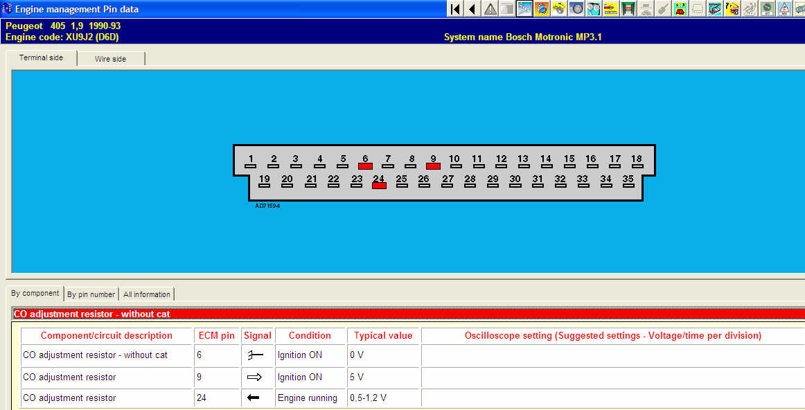

It only uses the same wires / ecu pin for the lambda that it also uses with the co pot, wire 24;
mix pot;
6; ecu earth pin
9; output 5v
24;input signal 0.5-1.2v

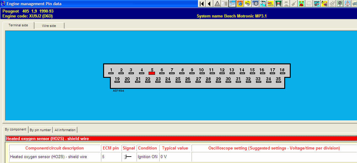

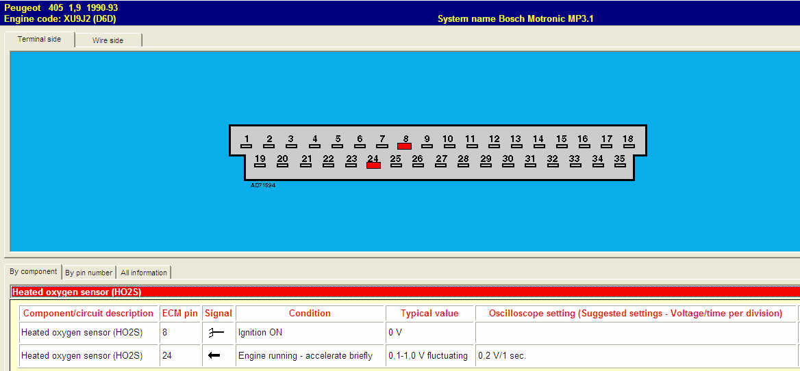

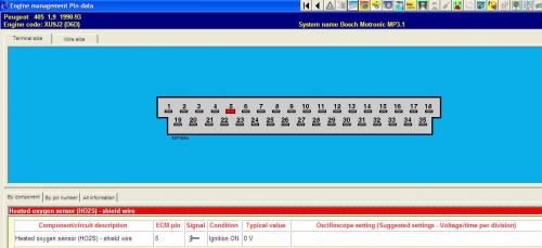

lambda;
5; ecu earth pin sheild wire earth
8; ecu earth pin red wire
24; input signal, engine running, 0.1-1.0v fluctuating.
