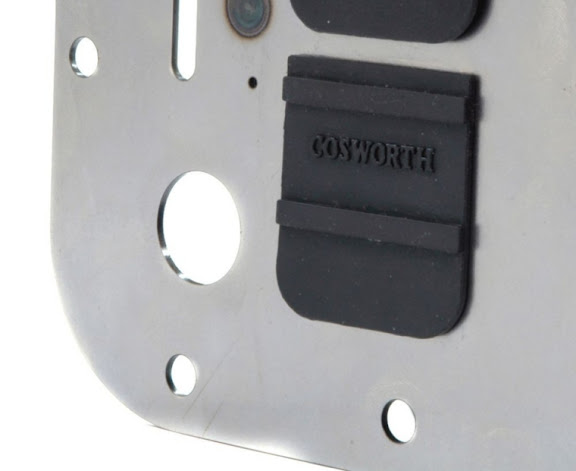

I am going to look into producing rubber flap baffle doors for dealing with oil surge problems.
These will be millions times easier to install into sump baffle systems than fiddling with hinges and metal trap doors, and are used widely in Peugeot Sport, Cosworth, BMW M3 sump baffles, etc.
I will also make sure that they cost much less than those available as BMW spares or Peugeot Sport items.
Please vote if there's any interest.

petert1345402284
Great idea. Those little doors and hinges are very time consuming!

calvinhorse
im sure you've research what rubber to use, most rubber will go rock solid at the site of hot oil.
