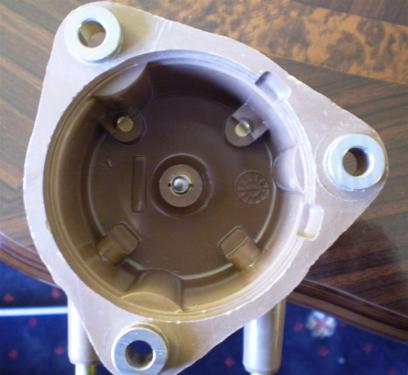

not really been through any puddles as such but the clutch was changed on a really wet day outside. tonight ive blown out the plug wells and given everything a coating in wd40, they didnt seem to be wet. i went ahead and took the cap off this is what i found....
http://www.shedbass.net/misc/03122007307_resize.jpg
that doesnt look like a healthy distributer cap does it lol? could that be giving me any problems? cheers guys
stuart.m
it certainly wont be helping your situation, id say a new cap is in order! as for the ignition amplifier, they are known to fail when they start to get hot so worth a try, get a new cap and rotor arm first anyway and see if it makes any difference.
KRISKARRERA
Hehe I've never seen a cap that bad! Well, apart from the ones that blew up.

yeah i think its definiately in order lol!! how big is the carbon contact supposed to be? could anyone recommend a good peugeot parts stockist? a few people keep telling me about that German French & Swedish?

I was lucky enough to pick up a genuine cap and arm on ebay for only £16 but it's rare for them to go that cheap. At one point it was about £50 for bother items from either GSF or EuroCarParts. From the main dealer it's £98. Yes, exactly. I think there's some place even cheaper than GSF and ECPs but can't remember where. Was discussed on the 205 forum. Main stealer is £82 for the ignition amp. I don't know if a Bosch parts place would still supply it but chances are it'd be cheaper than Pug. But it's your cap that's causin the problem.
Here's a pic of a new cap, sorry you can't see the sticky outty bit but it does stick out about 500000% more than yours lol

yeah that looks a awful lot different to mine mate! ill do some hunting around then cheers for the info. haha main stealer!! couldnt agree more. ill try find a bosch place when/if the time comes for the amp then.
when u say base plate im guessing u mean the plastic shaped like the cap that it kinda sits into on the head? if im correct and i can remember it wasnt to bad maybe a crack? the cap has a couple of cracks around the bolt holes
KRISKARRERA
Hehe I was just checking you had that plate. That cap in my pic is the genuine one made by "ducellier" and yours looks like the beru cap.

ive just been looking on the gsf site and they are around £20 each (rotor/cap) ill probably just go with that as it says they are ducellier, genuine sounds good too me mate :)

i stuck a new cap and arm in and its sorted... i hope... lol cheers for the advice as allways
