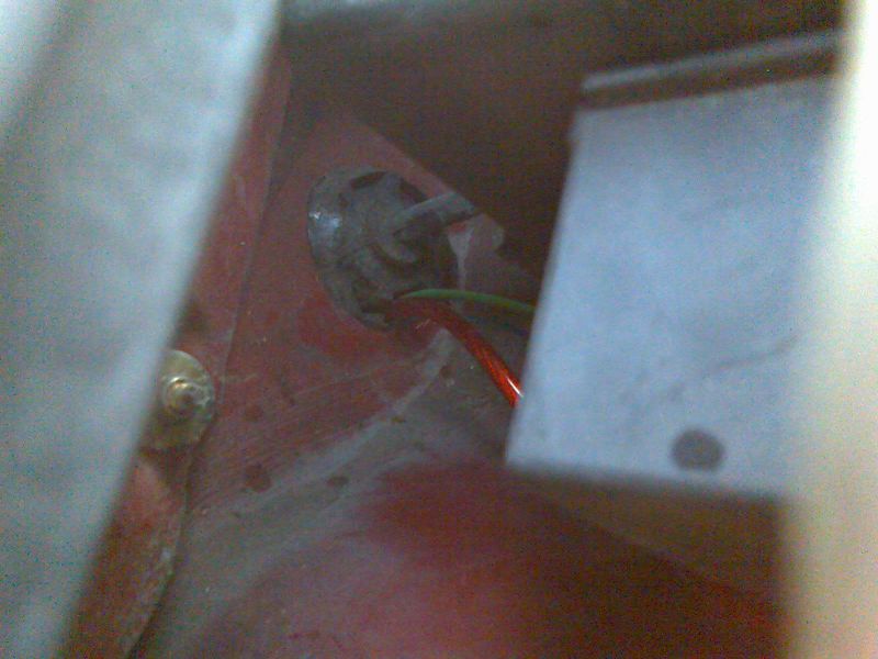

I drilled a hole in the bulkhead behind the battery and routed the power cable through there with a rubber grommet, and then poked a small hole in the existing grommet behind the ECU and put the wire through there:
(Again, apologies for the crap photo :rolleyes:)
i've relocated my battery to the boot and have to route the cable now, so this is great.
where exactly does it enter the cabin and what's the rest of the route?

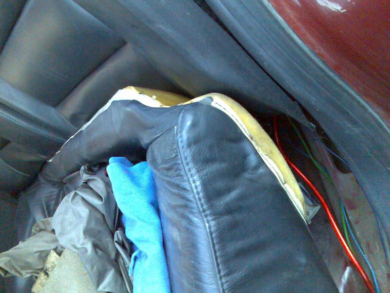

Power cable goes through the bulkhead here:

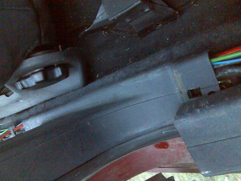

I've run the power leads down the n/s of the car, and the phono leads down the o/s:
That's as far as I've got so far, will post up more pics as I go :)
GLENF
When running the cable through the car always keep the power leads & phono/signal wires apart, peugeots are renown for feedback through the phonos due to being too close to live feed wire's. The best place for the phonos are down the centre of the car, but that usually means removing seats,centre consoles or carpets.
