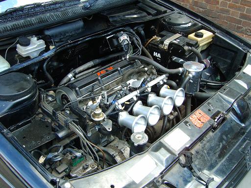

Thought it's been a bit quiet in the tuning section lately so here's a couple of pictures of my bro's 405. The spec we've gone for is,
KMS Throttle bodies and management
Catcams 283 cams
Catcams vernier pulleys
11:1 compression ratio
Quaife diff

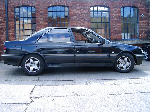

Ive put a picture on of the side profile aswell. Ignore the wheels as he's waiting for his 17's back from powder coating and he's also witing for the spoiler back from paint, but, i don't know why but i quite like it without the spoiler!!

Looking good :) This is a similar spec to how I'm planning on rebuilding my engine but I'll be going for Weber 45's rather than TB's (purely down to the fact I can't afford TB's yet).
I do like the spoilers on 405's but you're right it does look quite good without it! Bit of a sleeper

holemi
hi , just one question , why have you not put the cambelt cover on it ??? surely this makes it vulnerable to stones etc getting stuck in the belt and dislodging it :o and ruining all the hard work gone into the engine and car !!
Very true but it does make it far easier to adjust the cam timing when setting the car up.
Seen enough cam belts dislodged by stones with the cover on but this is mainly due to ditching the car in the gravel traps too often. As my bro is using it as a road only car then the risks are minimal.

I tell you what mate, it's rapid!!! I'll see if he is interested in getting it head to head as the performance is superb. Pulls strong up to 4500rpm and then at 4500 the back of the car squats about 3" and the thing takes off. Still pulling hard with no sign of dropping off when it hits the limiter at 7400rpm.
I'm seriously thinking of taking the carbs and management off the 205 and putting them on my 405.
yeah , i know what you mean , i am doing my own at the moment and its a pain in the ar*e....remove the engine mount to get cover off etc , :o ...
