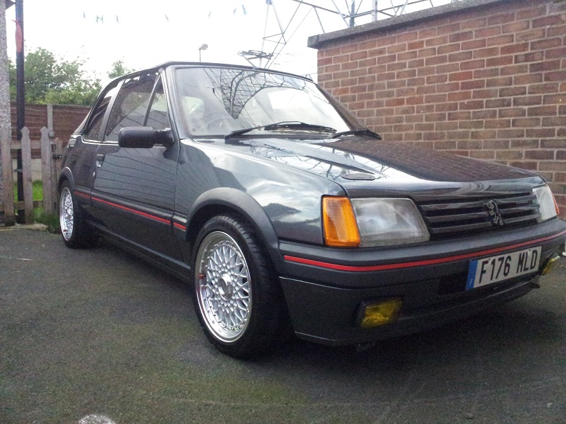

pip470 61 Posted June 12, 2012 Hi , I wanted to start a thread as i know there was a lot of interest in this car. Ellis has done a fantastic job on the car and I look forward to having many enjoyable memories with the cab. My plans. Well I think this summer has a little more to give, (well i hope so anyway) so I plan on getting the car back on the road with a gti 6 engine as soon as i can. I have a bottom end I rebuilt just after the euro trip, so i will couple that with the head already on this engine after a skim, new head gasket and a new timing belt and then i should be on the road. My long term goals are to build a turbo engine as i love the noises and the surge of torque. That should make a really enjoyable summer vehicle. I will get a lot of enjoyment from keeping this car shiny and clean as its in such good condition. Heres a pic after i picked it up. 3 Share this post Link to post Share on other sites

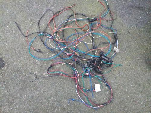

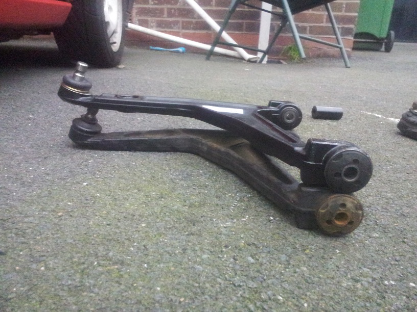

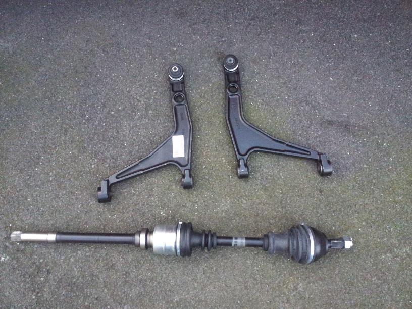

pip470 61 Posted August 3, 2012 Project driveshafts cont. Well i have fitted the new drive shaft and 309 bottom arms and this is what i found out. The wheel hub end of the drive shaft is fixed so even with the new shaft and the new wishbones in, it still does not move in and out. DOH! However, it is not shifting the engine over on every revolution of the shaft so thats a result. Had the tracking set up too because of how much the new wish bones affect the toe out. Had it set to parallel and will give it some time to get used to it. I also changed engine oil, fitted a new pressure transmitter and oil temp as they were not working. Changed the gearbox oil and fitted new seals to that too. The speedo i have not managed to get working yet, I though i had fixed it yesterday as i noticed at some point it has had a snapped cable and the snapped bit was still in the shaft with a cog on the end, i changed it with another i had in the garage but still no joy. next i will check if its plugged into the back of the speedo. Next project, Project get the car to turn off with the key. The car will only stop with the removal of the immobiliser key. The immobiliser key seems to be giving a constant live to the fuel pump. Will remove the panel and see how its wired up. 1 Share this post Link to post Share on other sites

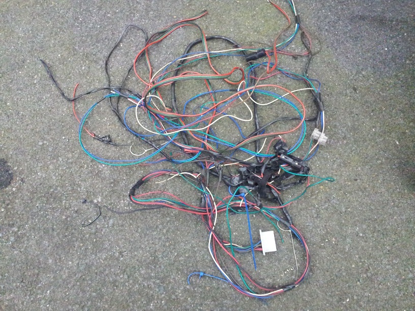

pip470 61 Posted August 3, 2012 I am enjoying it really. Its a lot different to my other project. Ive promised myself that this car remains fun and reliable. If there's a meet close by i want to be able to go as ive missed to many over the past couple of years. If only we had a summer I would enjoy it that little bit more. Today is a depressing day as its Ultimate Street Car at Santa Pod and i wanted to go but i have work early Sunday morning. Project get the car to turn off with the key. Ok so i had a look at the electrics and i found a live that was spliced in to the fuel pump wire. Disconnected it and removed the old school immobiliser whilst i was there along with lots of wires from past alarms. Now starts and stops with the key. Perfect. Share this post Link to post Share on other sites

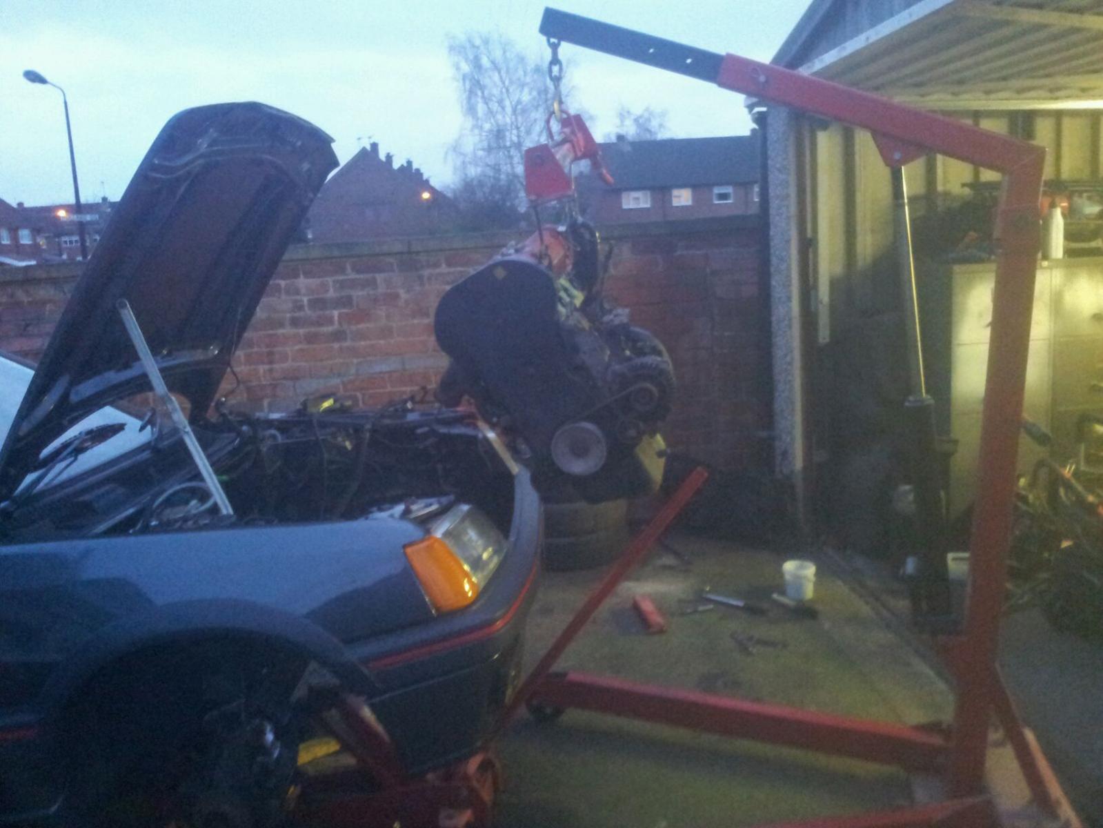

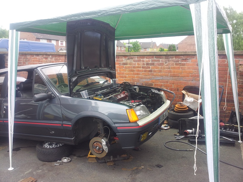

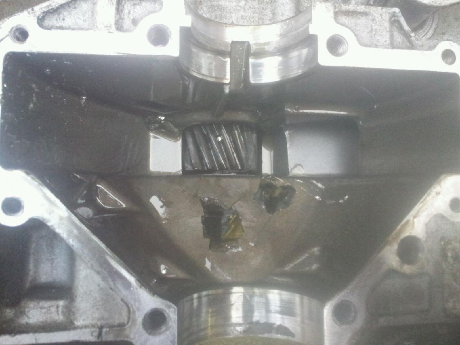

pip470 61 Posted February 21, 2013 Engine out today as i want to take the head of and change it as i suspect there may be a valve not quite seating right. I also wanted to get the exhaust manifold off as it is cracked so will need welding. Tried fitting my kaaz but ran into difficulty, at first i though it was because it was hitting the inside of the casing and locking up but i think its the bearing is damaged, so i will replace them tomorrow and see if it works. Out once again. Share this post Link to post Share on other sites

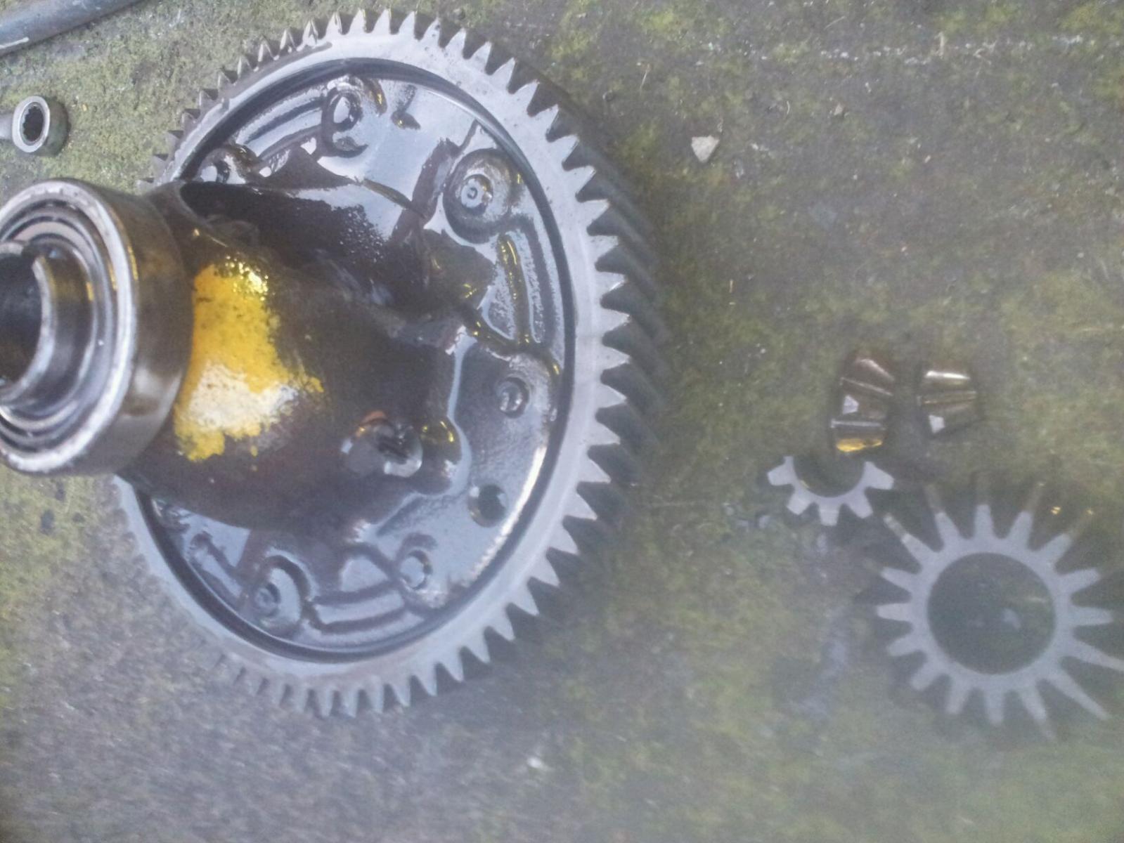

pip470 61 Posted March 12, 2013 Sorry Nick I missed your post. No I never sold it, which I am happy about. Engine is back in and starting with full compression so I will strip the other head to find the cause. Changed the diff bearings but it still locked up, found where I had to remove the metal and sorted that. Annoyingly the grumble is still there so the last thing I can think it is is the wheel bearings, hopefully i will have those done on thursday ready for the lakes trip on friday and then Santa Pod for Saturday and Sunday for The Fast Show. What a weekend ahead, I can not wait. I have started cleaning the interior tonight and if its nice tomorrow I will finish of making it look its best. Roll on summer! 1 Share this post Link to post Share on other sites

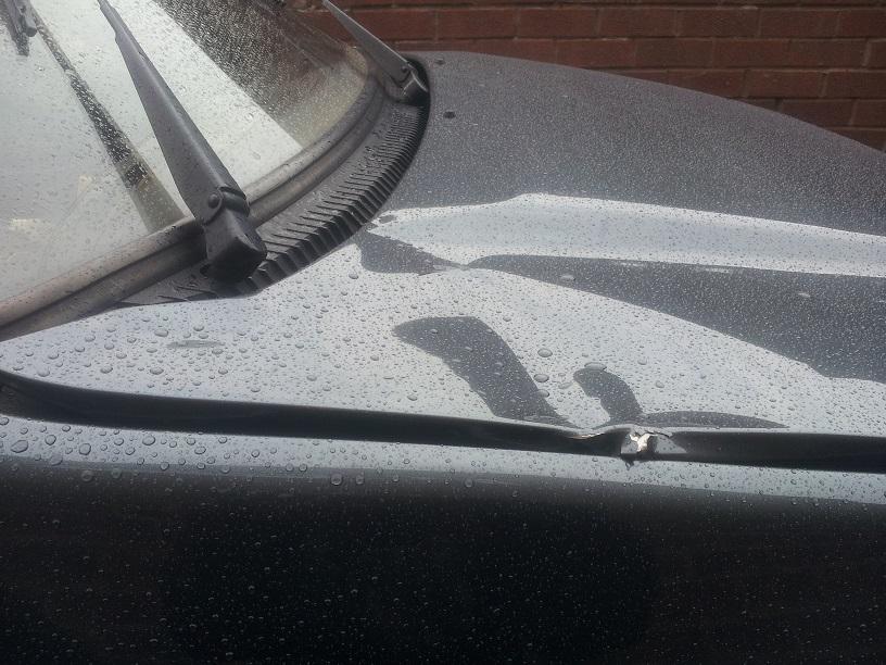

pip470 61 Posted June 4, 2013 Well, just to update this thread as i still have this car after a few times on ebay. I changed the wheel bearings and the grumbling noise is now a distant memory. I had one guy come to view the car but sods law on the test drive the car overheated and started misfiring. He wasn't impressed. The very next day i changed the fan switch and another coilpack and all was well again. However after changing the parts and sitting in the car with the engine running waiting for the fan to kick in which it did i thought i would take it for a test drive. Whilst joining the motor way the bonnet sprang up blocking my view. Nightmare. The bonnet is creased but luckily nothing else is damaged. Now im stuck in a predicament as the car only got up to £1550 and its going to cost me around £250 to put right and i just dont want to put anymore money into this car if i cant even get £1600 for it. If i break it it would be such a shame but i have to get some money back due to other projects. If money was no object then there would be no problem but owning 4 cars and a van is proving one too many. Need help. Share this post Link to post Share on other sites
