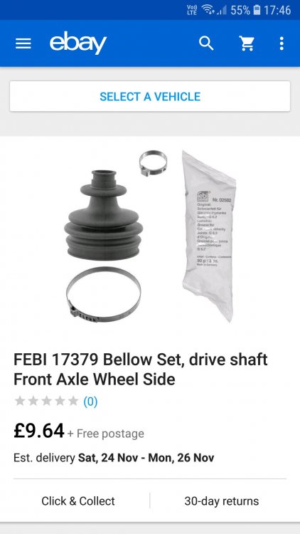

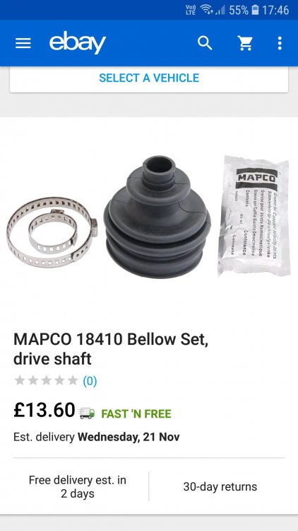

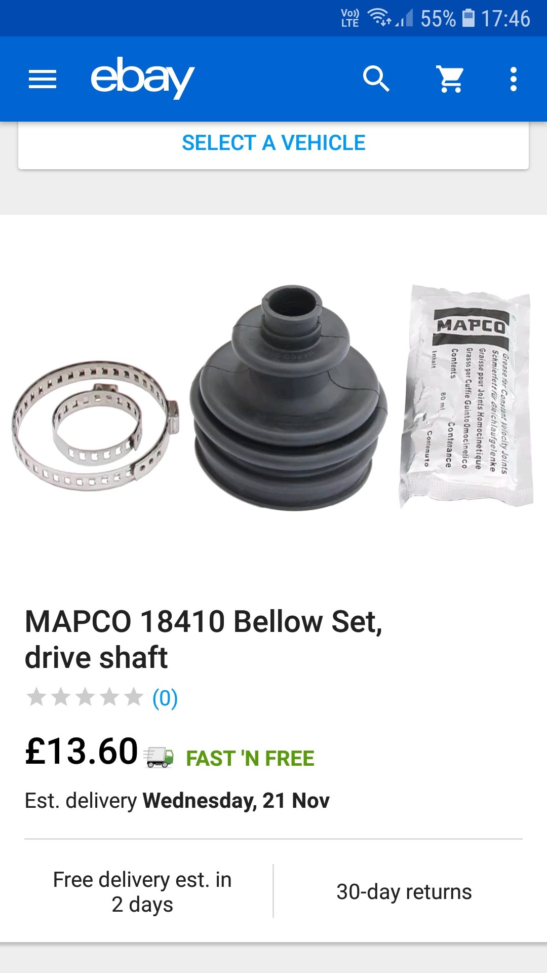

Callum 13 1 Cars Posted November 19, 2018 While topping up my gearbox oil I noticed the n/s outer cv boot has split in 2 so I need to replace it. I've looked on eBay using a part number I got from on here and it came up with a couple different types of boot could anyone give me some advice on them I want to use a oe one if I can. Share this post Link to post Share on other sites
Tom Fenton 1,650 Posted November 19, 2018 Buy the GKN boot from Euro Car Parts. Share this post Link to post Share on other sites
Ozymandis 104 Posted November 20, 2018 I wouldnt buy either of those. Further to this: The current GKN ones from eurocrap/carparts4less arent the same as the original Peugeot ones anymore, they are flimsier and dont last like they used to. I`m half afraid eurocrap may have bought a license for GKN branded ones and are trading on the name? Comparing an old stock peugeot one to the current GKN they are not the same. I have been buying old stock genuine for a while now. Share this post Link to post Share on other sites

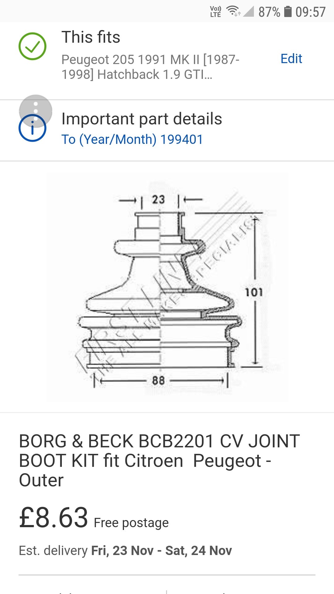

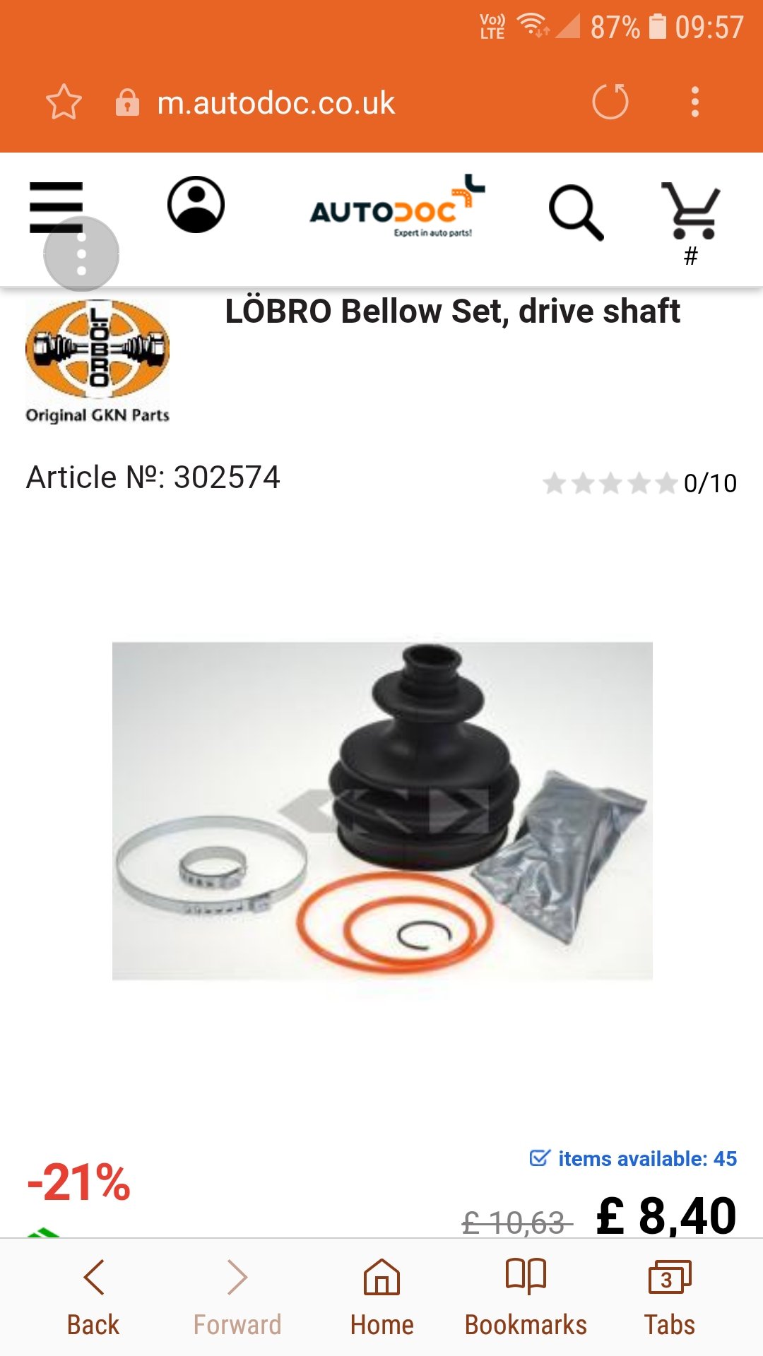

Callum 13 1 Cars Posted November 20, 2018 Would you sell one of the ones you've have? I've realised the size I need is 24mm inner and 88mm and the ones in the pictures above aren't that size anyway. I found this one which is the same as what's fitted on the o/s i think as that also has the orange rings and the one below I've found on eBay. Any thoughts? Share this post Link to post Share on other sites
welshpug 1,737 Posted November 20, 2018 the gkn one like tom said have been decent, the top one is closest you'll get to oem without buying at a dealer, does have the clip for the joint as well which many do not come with. Share this post Link to post Share on other sites
Callum 13 1 Cars Posted November 20, 2018 Great thanks for your reply I wasn't aware you could still get them from the dealer Share this post Link to post Share on other sites
Ozymandis 104 Posted November 20, 2018 Lobro is part of GKN, go with that one. Share this post Link to post Share on other sites
Callum 13 1 Cars Posted November 20, 2018 I did but i couldn't find it anywhere other than auto doc hopefully it doesn't take ages to come and is correct when it does arrive Share this post Link to post Share on other sites
