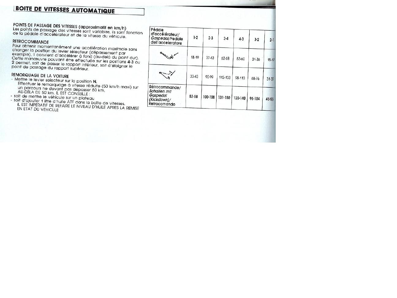

Thanks for that reply.
I am unable to read it, but I think I get what it is going on about.
It looks like the gear shiftpoints are based on road speed and not engine rpm.
Upshift
1-2: 18-19kph (11.1-11.8mph).
2-3: 37-43kph (23-26.7mph).
3-4: 62-68kph (38.5-42.2mph).
Downshift
4-3: 53-60kph (32.9-37.2mph).
3-2: 31-36kph (19.2-22.3mph).
2-1: 15-17kph (9.3-10.5mph).
