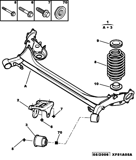

Henry Yorke 270 3 Cars Posted May 14, 2012 Mine has only done 70k and I have never changed them, though it does make the odd clunk at the back. What mileage are you changing them at? Personally I would change both at once on a part like that for equal stability. Letting the trailing arm swing down is easy as it is just the shock bolt as you say and I have done this to change the rear springs. The front is held on by some big bushes which I have often wondered if they wear badly over time (part 8 in the pic below - 5131.A4). They look like they would need to be pressed out though. Not sure where part 2 mounts to the car though, but it doesn't look like a rubber sandwich mount to me, so the only real bushes must be part 8. In that case you might be able to unbolt the front and let the front of the beam drop and use some puller on it.... I'd take the whole lot off though. Have a look on eBay for second hand beam pics to get some idea. I think I'm right. Share this post Link to post Share on other sites
vern 0 Posted May 15, 2012 The car has done just over 102000 miles, I have had it since about 88000 and it has always knocked gently, and the bushes looked cracked. The past couple of months it has got worse and it passed the MOT 6 months ago, the bushes have always looked cracked. Part number 2 bolts directlyto the underside of the body, and it is the big bush you have pictured that requires replacement. Has anyone tryed freezing the bushes to get them to shink enough to fit? Share this post Link to post Share on other sites
Henry Yorke 270 3 Cars Posted May 16, 2012 It looks like the usual Peugeot method of chisel out and press in You light be able to get away with a big vice to do it though Share this post Link to post Share on other sites

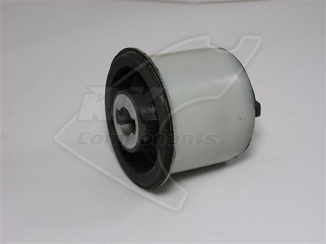

vern 0 Posted July 19, 2012 No when I sold the car I gave them to the new owner but they were only £14 for the pair from this place: http://www.ebay.co.uk/itm/PEUGEOT-307-REAR-MOUNT-SUBFRAME-BUSHES-2000-2005-X-2-/230571170042?pt=UK_CarsParts_Vehicles_CarParts_SM&fits=Car+Make%3APeugeot%7CModel%3A307&hash=item35af1cd8fa They seemed ok, looked the same as others on ebay, obviously cannot vouch for how good they were when fitted. I think they are only something like £40 the pair genuine Peugeot. Share this post Link to post Share on other sites
