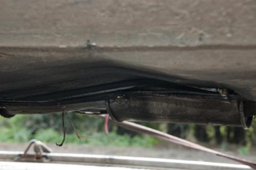

I had an 'oh s***t' moment on the way home from work on Friday. At first glance, I think the car looks fixable (almost certainly a cat c/d write off - but it means a lot to me and I want to fix it if poss).
However, the view underneath is less rosy - will the bent floor elevate it to a cat B ?
I know I should consider myself lucky as I walked away from it, but right know I don't :(

Having seen the trivial damage it takes to get cars written off, I'd imagine that's going to be a cat-C minimum, before they even see the dented floor.
Toddy
Are you sure the floor damage wasn't there previously eh!
If it only affects one side you could park that side against a wall come inspection time.
Can you tell us the rest of the story of how you ended up in the woodland?
Cheers
that curve in the floor is there as standard, if the doors are opening and closing fine don't worry about the dent.
I wouldn't bother claiming unless it involves another party, so the category thing doesn't come into it.

Well, I'm not 100% sure what happened - a car pulled out in front of me in an NSL where I was doing around 50. I had the choice of hitting the brakes or going round them. As there was nothing coming the other way, I went round - as I pulled back in, the back suddenly stepped out and next thing I know I'm in the shrubbery ....
I'm sure the floor wasn't bent before - and its both sides. Both doors open fine, but the drivers side won't stay closed. The insurance already know, as I had to go through them to get it recovered - still doesn't mean I have to claim I guess.
Seriously, about the floor, would that make it an 'unsafe to ever go on the road again' job ?

WP is right that there is an upwards curve on the floorpan a standard. It's a little disconcerting, because to the uneducated eye it does look at first like the floor is dented (I'm talking about 205s in general here, not yours). But - and it's difficult to tell from the photo - yours does like like pointing up more than it should, and looks like the exhaust is bent too. Just give it a more thorough check.

You may want to edit the photo to remove the registration mate. If you end up breaking it I would be interested in the bonnet if its not too badly damaged.

looks like a Cat B to me, floor pan is damaged.
Buy it back and reshell.
mine had similar damage from being forklifted when it was recovered after being nicked, just kicked the dent back down :D

Reshell sounds a bit dramatic to me! Unless there is significant damage to the chassis "leg" that supports the inner wing I can't see why you would want to reshell that.
I wouldn't worry about the floor, just give it a hefty belt from above, they are very easy to dent.
As for the door not staying shut, usually the outer handle sticking is what causes that. Give it a wallop with the palm of your hand a few times and flap it open/shut a few times and it will probably be okay.

What I would say is that you spend all the time and money fixing the dents and all the broken bits and still end up with a car that doesn't doesn't feel quite right and could quite possible be slightly bent just like my Rallye and the sorrento Anthony recently part'd.

That does worry me, so I guess I'm just going to have to see what the assessors say. I can't help but wonder now if something failed catastrophically anyway as I wasn't going fast (50 ish) and there's no sign of skid marks from a lock up or similar on the road..

If your wondering whether that's going to be a right off or not it seriously is, no doubt about it.
Saying that I had my Rallye repaired to the value of £2000 when it was only worth ~£750, although that was because I was rear ended and was in no way my fault, so I don't think you'll be so lucky.

I used to work in salvage and have a good idea of what category a car should be; get me some more images and I can give you my best guess. But be aware that there is no real guidelines and I've seen old cars with worse damage given better ratings than newer cars; maybe the inspectors have a soft spot for old classics.
