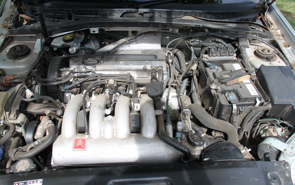

Its the later MK2 frog type car. I have attached some pictures
Pictures are too big sorry....
Not sure how to compress them

Sam. The car is in Australia, we had a few left overs sent here. Production actually stopped in 2006 I believe according Wiki. It also states the the j4rs stopped in the xsara in 04 so makes no sense. This car definitely has the rs motor as pictured though.
