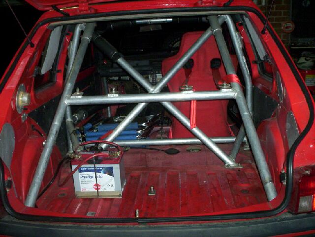

Very nice, thanks. I notice that not many designs pickup the forward rear suspension mounting points. A previous car I owned had a bolt in alloy cage, early '90's vintage. In addition to the rear points, it had diagonal bracing picking up the forward points as well.
I found a pic. Overkill?

Yeah, I've done one before where a bar runs over the top of them from the rear mounts to the bottom of the main hoop, but this is supposed to be a fairly cheap cage. They might go in at a later date.

Nice cage,everyone has there own opinion on cages.Most works competition cars you see now have a vertical double diagonal right behind the seats,that's what my dad was advised to get on his 106 rallycar by the protection and performance who did his cage.

Yeah, I prefer the cross in the main hoop too, it gives you more room to put the engine in the middle.... ;)
However, the reason it's usually put in the back is that even though it's at an angle if the car goes over sideways, you usually have at least one kink/bend in the main hoop to follow the bodyshell, and in the case of quite a few manufacturers - that CC one Cameron has for instance - there's several, so you no longer have true triangulation between the diagonal for rigidity - to stop the frame being pushed over.
It's not a massive difference, but it makes it enough that the one in the rear makes just as much, if not more sense to have. Especially if you're putting the harness bars back there anyway...
