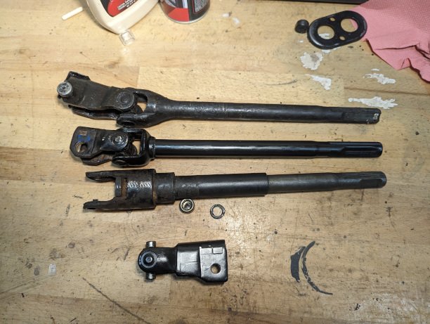

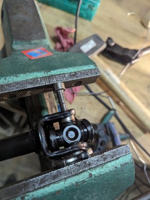

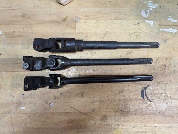

I am doing the same modification (xsara rack and saxo pump) so I tried and order this exact column that was available on autodoc. It's the same a the one that was on my 1985 non pas 205 GTI.
The three colum are aligned at the pivot, from top to bottom, the xsara one (longer on the driver side and shorter on the rack side, and too big for the boot), then, my stock 205 non pas square one (too long to fit the xsara rack), and the sasic one, it's the same as my non pas one. I think that there was no square pas column on 205 (I have one pas rack, and check a lot of ad picture with no luck).
So I tried the "Tom Fenton method" (I was a bit tricky, and I am not sure that I did it the right way) :
And voila, my stock one, and below, the mix of the sasic and the xsara :
The bearing suffered a bit, but, it's still smooth. I didnt do the welding spot yet, it looks pretty stuck in there.
Thanks Tom, I would never I have think or try it if you hadn't documented it.
Pierre

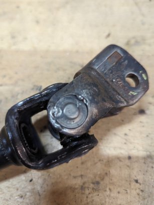

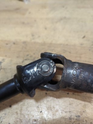

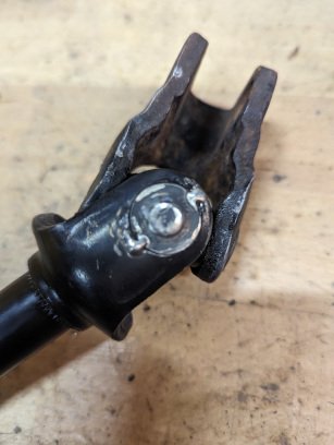

You need to do something to ensure the bearings are retained. There is quite a bit of load on them when steering the car. If one comes out you could suddenly lose steering which will likely not end well. If I did it again I would probably make some washers to hold the bearings in and then tack the washers to the coupling.
Pierre_b
Hello,
Thank you for your advice, here some picture of the weld I did tonight before putting a lick of paint :PXL_20240422_210404505_MPs.jpg.904d01a510c45305159a94bf9a727346.jpgPXL_20240422_210344249s.jpg.bd91d9dd0a8d354098a2182dbb043474.jpg
I hope that I will stay attached.
Pierre

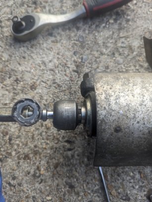

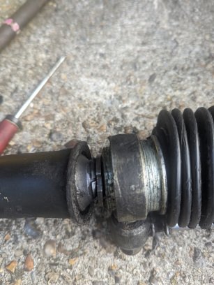

I am still on the project, I need now to fit the connecting rods, that I got from a 205 rack. On the rack, there is some self locking washer :
On the 205 rack there is a flat, and the washer seats on this flat. It seems like a locking device. On the xsara rack, the flat is not there, so the washer seats weird, and doesnt do the locking feature :
Do I need to put something, or I leave it like on the first picture ?
Thank you for your advices,
Pierre
Can you make the locking washer work? If not, I'd probably apply some 262 Loctite and call it quits.
Pierre_b
Hello,
Thank for your answer.
I don't think I can, there is no flat like on the 2 205 rack that I have PAS or non PAS :
I dont remember for sure, but I think the xsara rack had any locking system when I took it apart.
I'll go with some thread locker to be sure.
