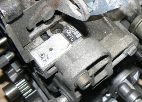

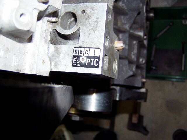

That's the serial number :).
The code will be on the other plate.
Where could this plate be located exactly?

cybernck
The other plate is usually located somewhere near the alternator:
Thanks to petert for the pics ;).
