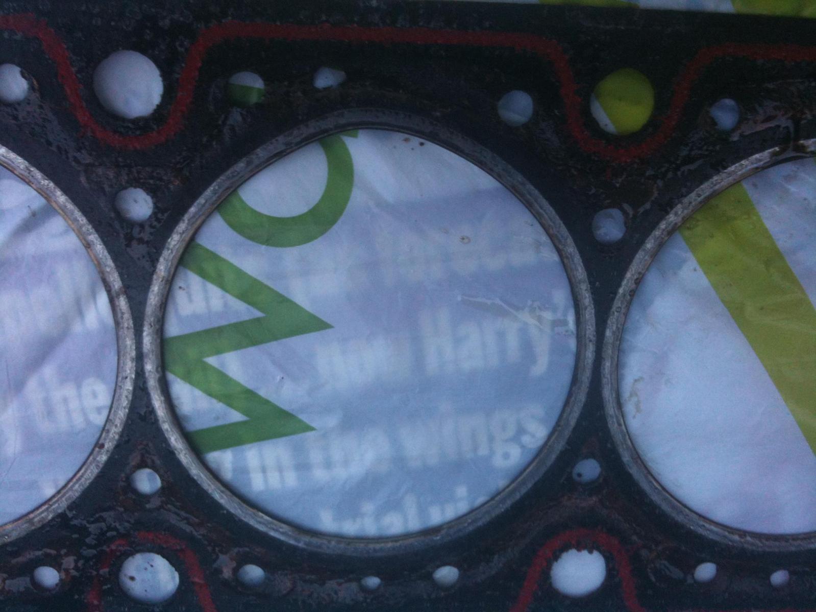

Hi guys, thanks for the replies.
So I took off the head yesterday as I was sure the gasket had gone and was hoping that the lower compression on number 3 would be due to the gasket going on number 3.
Sure enough as you can see in the photo that the gasket has gone and it was on number 3 where the gasket has gone to an oval shape! It went on the front of the block.
From what Peter has already said I shouldn't be getting a thicker one but my question is - will it be worth getting a steel gasket as opposed to a std one? This is to cope with the rather high compression.
Any info, as ever, is greatly appreciated!
Simon
I don't recall seeing a standard steel gasket used on an alloy XU, they're only standard on the RS iron block engine, and the EW alloy blocks, though their liners are cast in.
your compression isn't particularly high, only 0.4-1 more than the standard D6C, I would check the liner protrusion and get the head checked over
pp205
The head is being checked in the week, the liners were professionally skimmed at the same time as the block so there shouldn't be any issues there but I will get them checked.
So the standard gasket should be fine?
Cheers
I've run that head gasket at 11.5:1. So should be fine.
