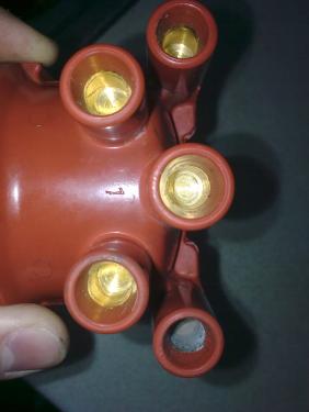

Hi folks,
I'm after a bit of help locating the right distributor cap for my distributor. The car is a 1.6 CTI with a Bosch distributor: 0237009063 fitted. The cap I'm after is a clip on one with the plug lead sockets inset into the cap. I've just been to my local motor factors (which I always use) and they couldn't find it in their books. I've just had a look through Peugeot service box and it would seem I need a '5900 E2' however I can't cross reference that with anything in the Intermotor or quinton hazzel catalogue. Any clues guys?
Cheers
Steve

Thanks Welshpug, always to the rescue! That's given me a good Peugeot number to go from, however I can't seem to get it to match up on Intermotor or QH's parts list. I've had a look at an old box that my last dizzy cap came out of and it's an Intermotor '45830', when I chuck that in on Intermotors website it gives me an OE Pug number of: 5941.32 Yet that doesn't seem to relate to anything on service box. A pain in the ass, I'm tempted to go for another Intermotor 45830 off of ebay and put it on, although maybe that's been the problem all along, it's had the wrong distributor cap for the last few years :/
