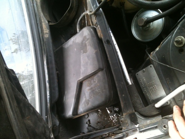

Hi
I found out that the water coming inside my car is from the area of the front washers , their motor and the sunroof vacuum black box
what i mean is : on both sides there are 2 holes for letting water drain down to the front wheel arches.
as soon as water starts to drain , it starts to get inside too.
what should i do now?
any idea would be appreciated . please

M@tt
behind the wing there are several panel join seams, you'll proabbaly find the stonechip has cracked, allowing water in as it trickles down the inner wing

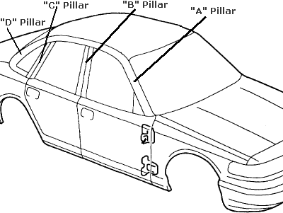

omri617
"infront of the door halfway down the A pillar"
Im afraid i didn't get you , is it hidden by the door? i need to remove the door in order to get there?
i have no idea what's A / B pillar
:wacko:
A pillar is the front pillar the door hinges attach to. You need to remove the plastic panel at the side near where your feet are. Then there is a bolt in there pointing outwards to undo.

Hi , took off the front wings today and saw some cracks in the metal/in the adhesive , which i believe the place where water coming inside . how can i fix it? which material to use to seal it?
thanks
davey sprocket
We've no idea what's available where you are but try Googling "car body seam sealer"

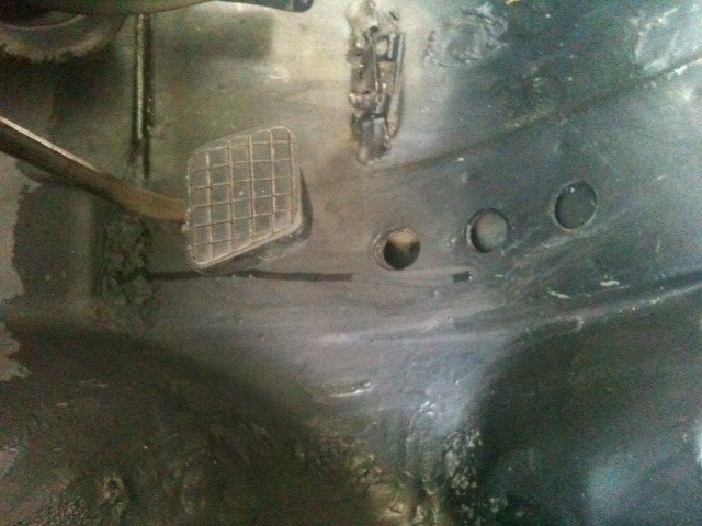

UPDATE :
Removed the front wings , made some cleaning and sealing with a great adhesive and it fixed the problem. now , i found a "new"
area , a new leak which i ask your help in identifying and fixing .thanks...
