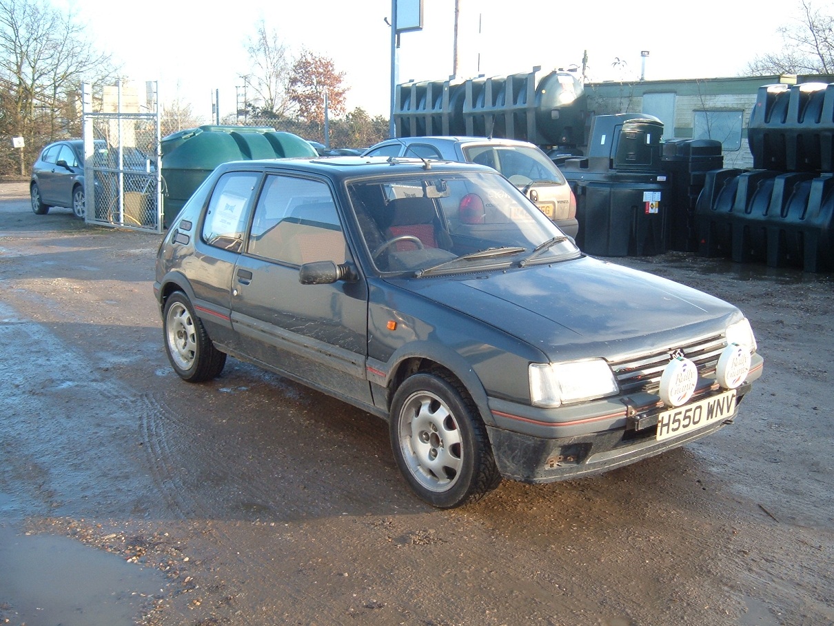

This is what I am using

Those are the same as mine,was on the car already so not sure where they come from
arwel
Same as mine too and mounted the same way. I may be wrong but I think they came from Peter Lloyd Rallying and originally designed for mk2 Escorts. ;)

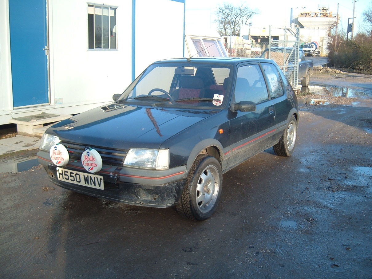

This was the home made effort that was on the 205 I bought a couple of years ago.
The car is long gone but the brackets and spots are still sitting in the garage.
