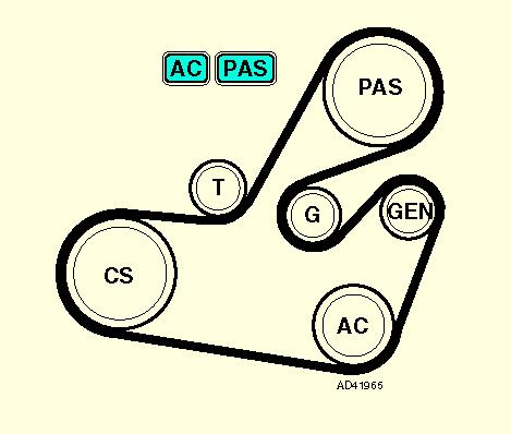

My fiancee has a 206 GTI with a/c. The aux belt snapped earlier and now the car is dead as in flat battery so need to fit a new aux belt. Two troubles with this are...... I have not got a clue which way the belt goes on as in which pulley/tensioer it has to go under or above, tried looking via Google by typing in '206 GTI aux belt' but no joy......So I need a picture or diagram of how this goes on.

Not seen it on boxs before mate? Fitted a few in my time, easiest is a Golf VR6, 5 min job!

davepug205
Beat me too it :D just got the same pic off autodata online.
Cheers

Thanks guys.......That will save me so much time ;)
