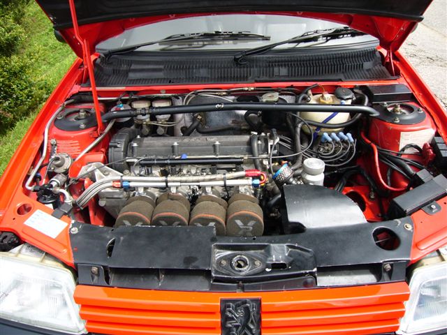

May I suggest you to relocate the battery to the boot, then you will have plenty of room for the air-flow meter and the filter. Also, you may consider to fabricate your slam panel so that it ramp more cold fresh air to the filter.
here is what i did a few years ago.
