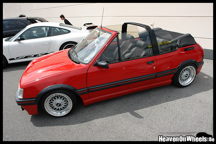

I love the BBS's. I've seen a CTI with them on before and they look good. Are they the right offset or are you going to adjust the dishes or run spacers? I'd have some for mine but they are pretty rare and expensive in the UK

@Henri I had spacers made up for them, turned out to be quit an expensive story but i had no choice really since ET is 24 and i want to fit 4pot Brembo's as soon as the T16 engine wil be fitted.

ET24 is an odd size, unless they were done for a 405 or a newer model like a 206 / 307. Are they 16"?

These are 16"x7 BBS RS 008 5x112. The sideskirts were painted this summer actually. The one's on Wesly's CTI are 15" but i wanted a bigger size so this made matters much more difficult. I came by these in Sweden for a reasonable price but as you said they are expensive in fact you can by a decent 205GTI for that kind of money.

Ahhh ok, you will have had to have made a 12mm spacer and had it drilled to 5x112. Any pictures? Luckily it is the new VAG wheel stud pattern so that explains why you could get them 4x108 in BBS is really rare
