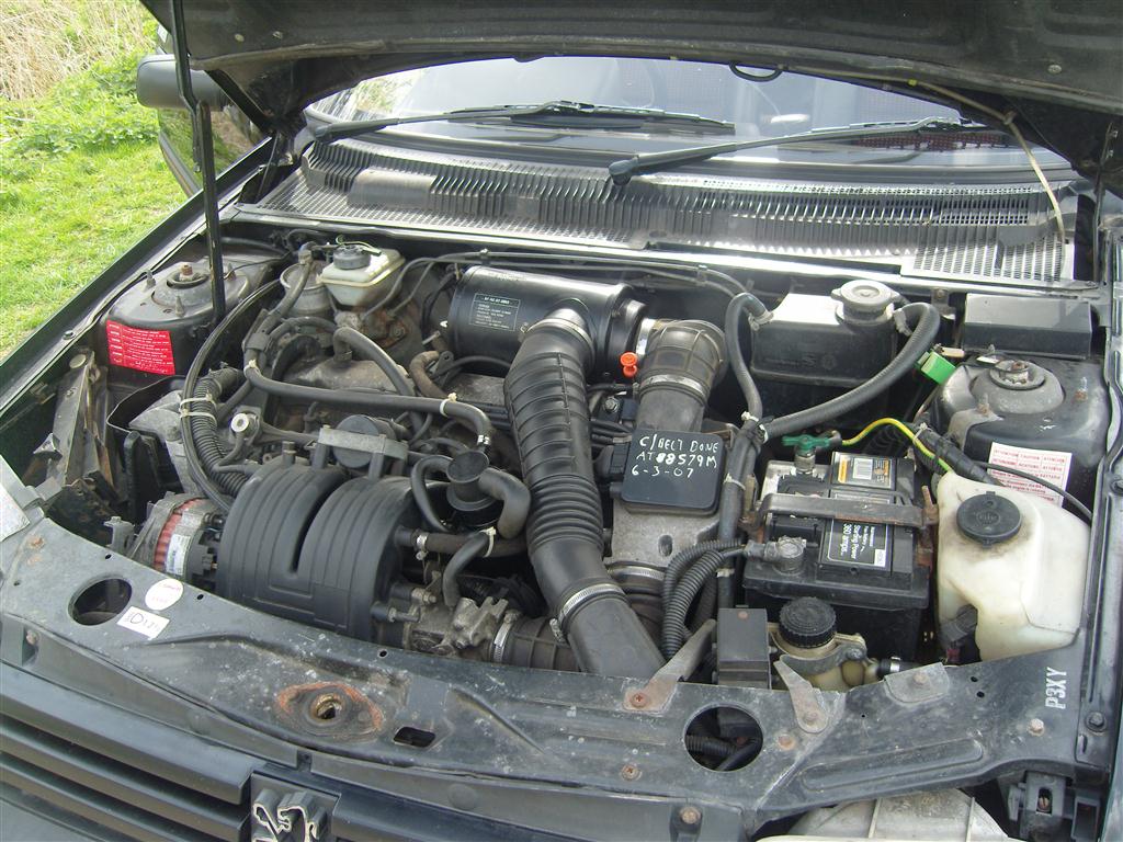

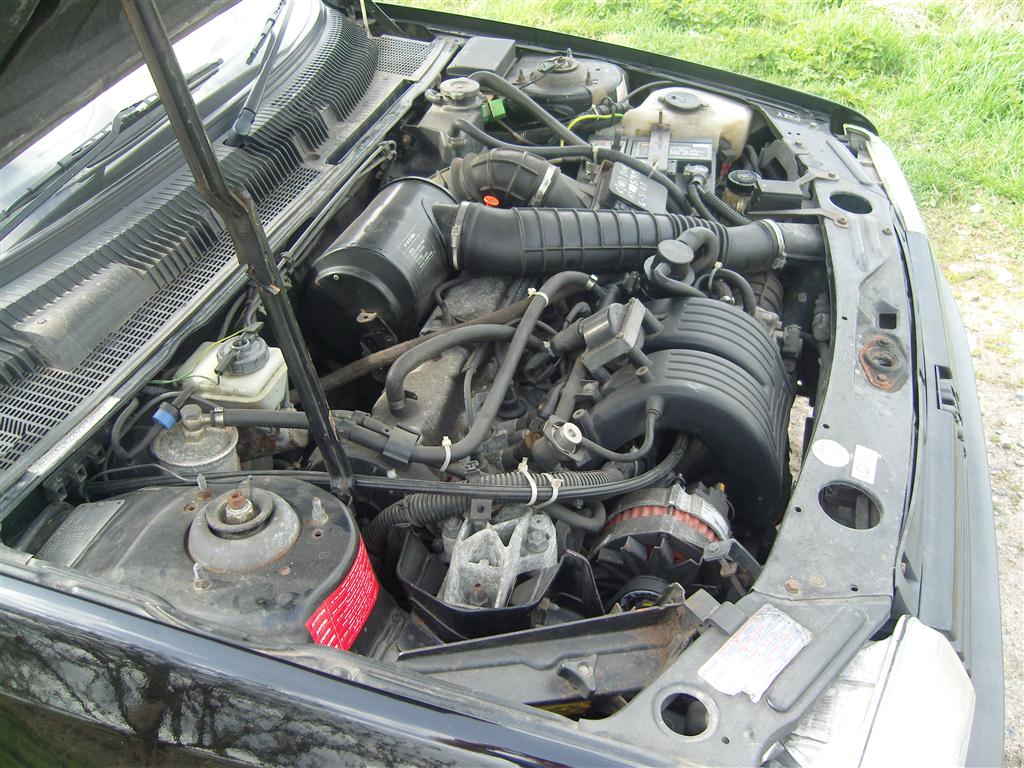

Hi,
Can someone upload a picture of plastic intake manifold from 1993 / 1994 GTI , and fuel rail on it. I want to replace it in my car and need to know is it any different then my old manifold.

is this any good to you?
or this

I used the original fuel rail & FPR from an alloy manifold when I fitted the plastic inlet to my car, I enlarged the mounting holes on the metal rail with a rail to make it fit correctly.
Main difference is (beside material) is the fuel hose being a push fit onto the plastic fuel rail rather than a proper threaded union as on the metal fuel rail.
